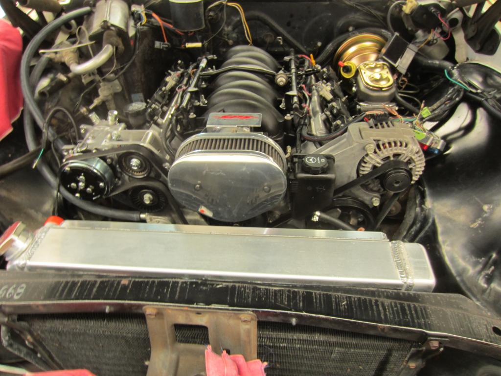

Default Re: Webster's 67 Bel Air Conversion
1.Moving along........Got the Power Steering reservoir mounted ......Mark brought over the correct A/C compressor.....got that installed using Kwik Performance brackets.......(Great Stuff).....got the column shift linkage installed ...... Torque converter bolted up.......I started getting the fuel system installed........Mark modified the stock tank for the LS application........I got the Filter/ Bypass installed and started on the fuel lines......LOL........The lines that Mark supplied are different than the ones I was used to using and after trying for 45 minutes to get one fitting installed.........I threw in the towel.......So.....The car is going back to Mark with just a bunch of Mickey Mouse things left to do........In the pic with the A/C compressor installed, I had a spare 99.5&quot; belt laying around but the directions call for a 101&quot; belt.....the one I had was too short as you can see so Mark will be getting the proper sized one.......New Driveshaft is also installed.....

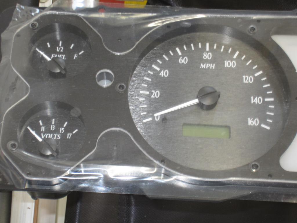

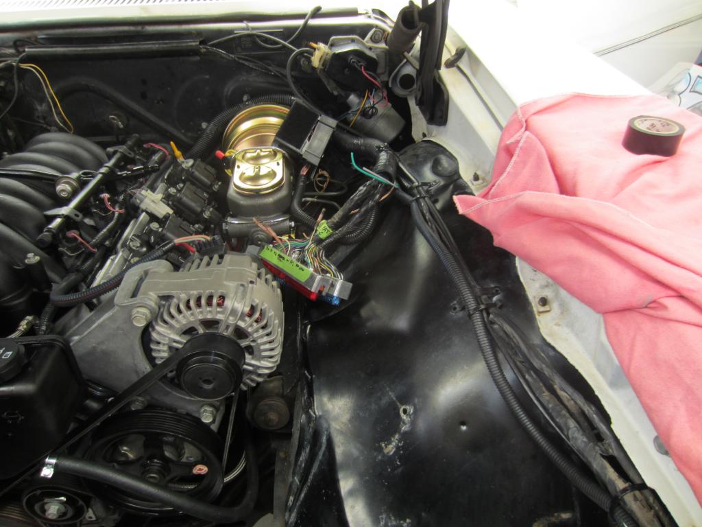

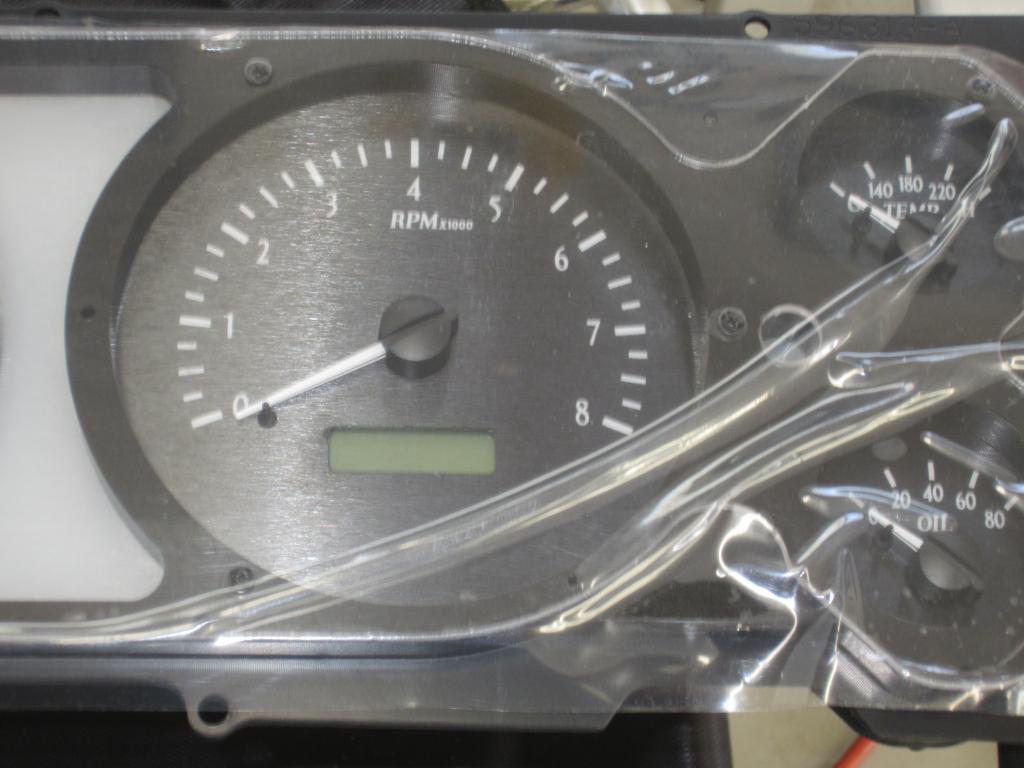

not quite as dramatic as kens days just finished up a lot of wires
1967 bel air 5.3 4l60e
  #88
Old 05-02-2015, 10:31 PM
L78biscayne's Avatar
L78biscayne L78biscayne is offline
Join Date: Jan 2003
Location: brooksville fl.
Posts: 160
Thanked 2 Times in 2 Posts
Dakota digital vhx dash
