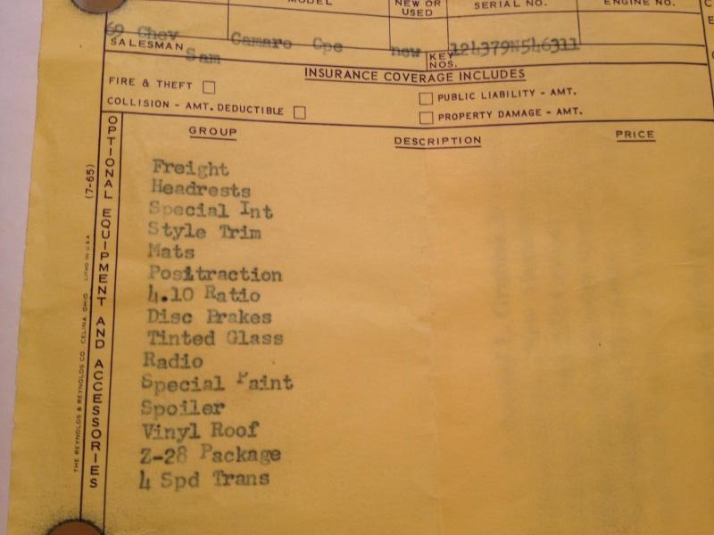

I'm well aware of how the car was initially ordered. EO was not a current model year color. So Central Office contacts the dealer proposing a substitution. His wife worked there; says ok. Maybe never mentioned it. That car was ordered 47 years ago and there is no mention of EO on the original paperwork. The "paperwork" you have posted was done decades later. 47 years is long time. Look up #81 on AutoColorLibrary.com under '69 Oldsmobile-looks very similar to EO but in reality is much lighter. Maybe that's why the owner was disappointed?

Are you saying this was done decades later ?

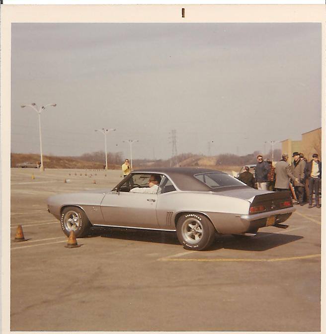

Does anyone have period pics of the car from back in the day ?

the paperwork is fake??? maybe I am wrong, but seems 'special paint' would mean more than just stripe delete . Are there any other examples of stripe delete cars w paperwork?? how is it worded on their paperwork???

Looks lighter than EO to me but I see the purple tint.
