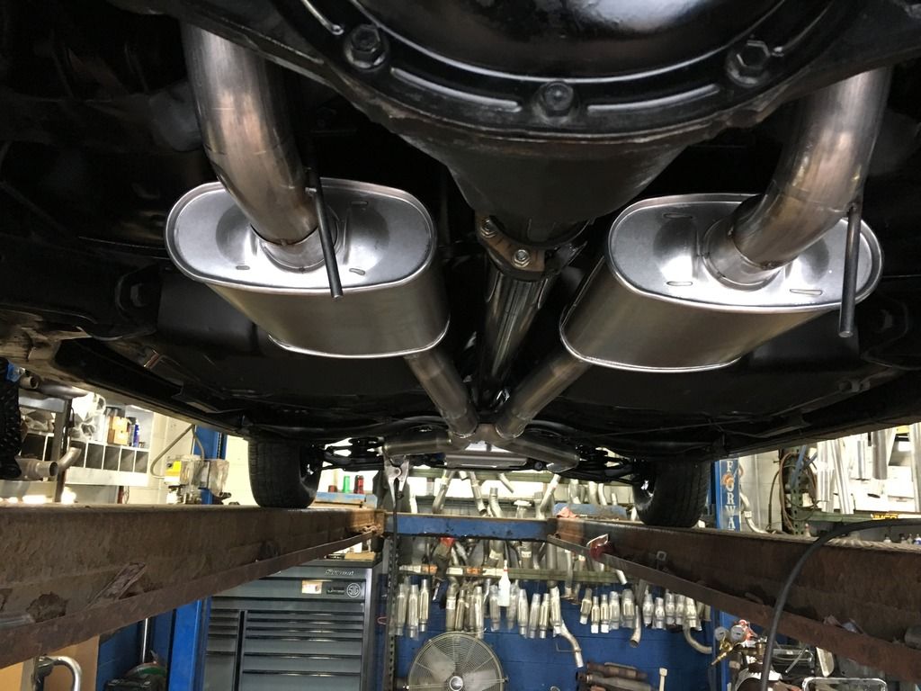

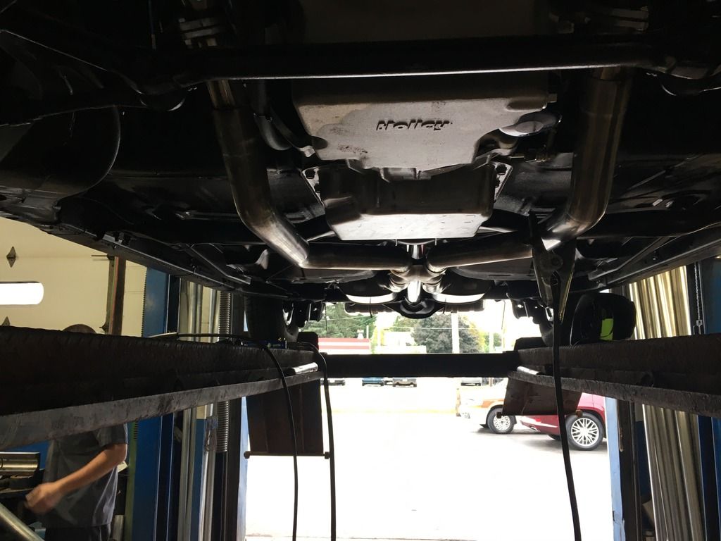

Exhaust is in and the car is back........Another great job by Dave's Mufflers in Kenosha.......James works his magic again

----He is going to waste those tires......Bill S
  #86
Old 10-22-2016, 10:46 PM
napa68's Avatar
napa68 napa68 is online now
Join Date: Oct 2008
Location: Presque Isle, WI
Posts: 3,720
Thanks: 5,582
Thanked 4,671 Times in 1,217 Posts
Default Re: Andy's 66 Caprice LS Conversion Upgrade
Those tires may be the only thing to keep that 10 bolt alive [img]<<GRAEMLIN_URL>>/[/img]

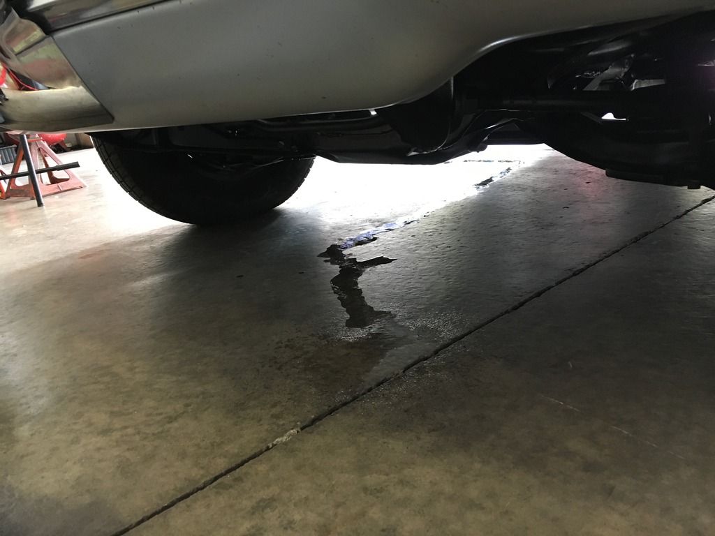

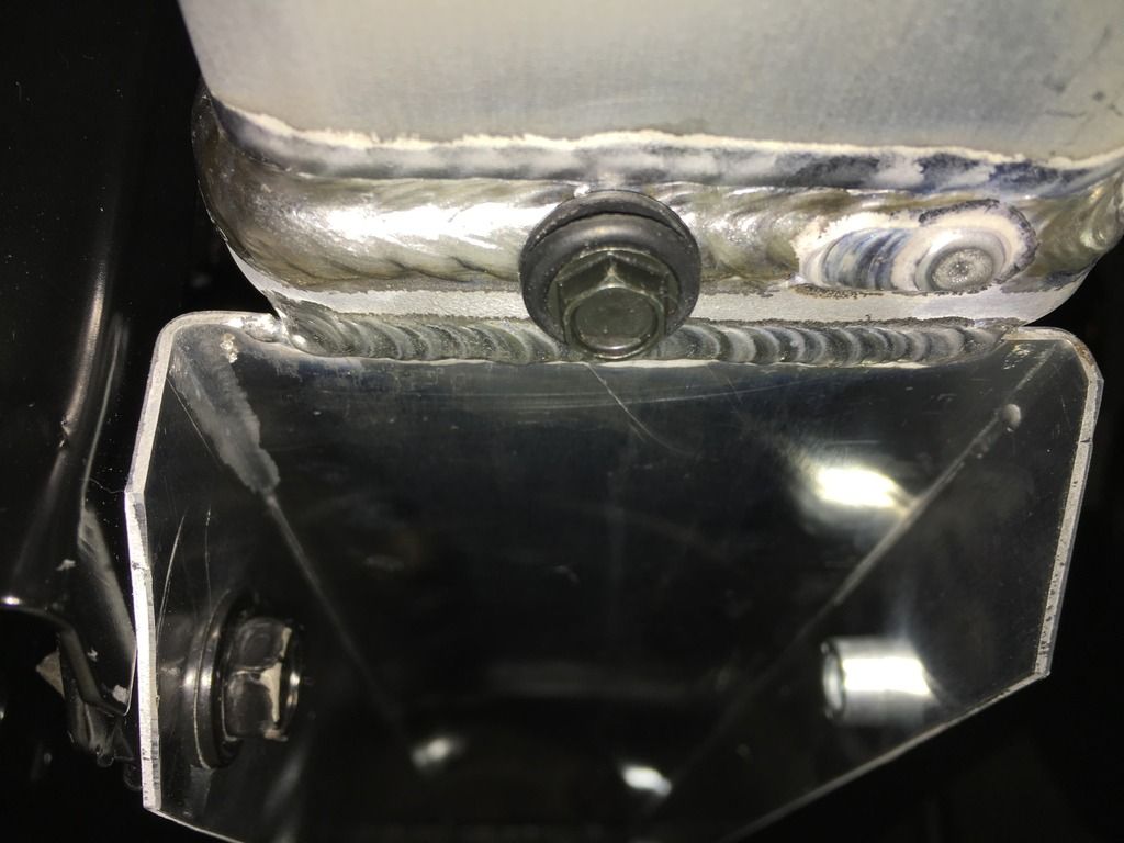

Got pretty much all the under hood wiring completed today......went to spin the engine over and found out the neutral safety switch is toast......Andy ordered a new one and that will be his winter project to install it.......LOL....Then we had a major disaster.......added coolant to the Radiator to top it off and come out the next morning and a puddle of coolant under the car......Humm !!!!.......Ended up being a pin hole in the Radiator weld seam..........Sheesh !!!!.......First we had Keith's car dropping dirt all over the place, now we have Andy's &quot;Leakasourus&quot; dumping coolant all over the place.........Time to call the Hazmat team again ............Time to get this &quot;Beater&quot; out of the garage......Andy is coming to drive it home next Saturday...........Put a self tapping screw with a rubber grommet thru the Radiator hole and tightened the screw squishing the rubber grommet to seal the leak till the new Radiator shows up and Andy can replace it at his place.......LOL
