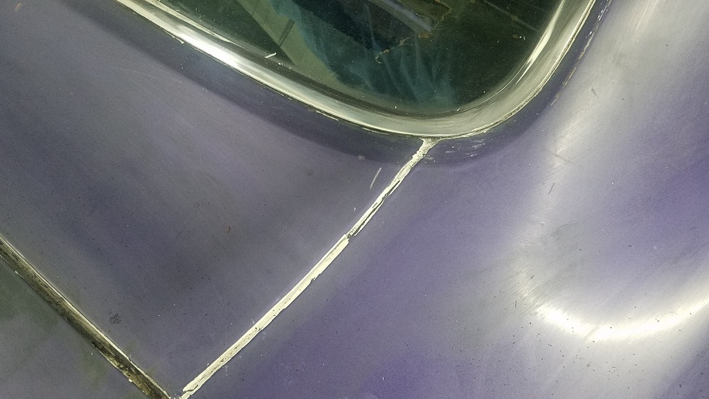

![]() Quote:
I do know the rear window stainless was black on rear window louvred cars. It was on my 71 'Cuda |
