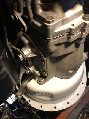

To all,
I have a hone o drive setup for my chevelle that was part of the original equipment from Motion. The problem I have is that I need to speak to somebody who has one in a car and has understands the workings.
My unit looks great but how do you know if it is in 1:1 gear or reduced in overdrive? How does the shifter work and what happens to the hone itself?
Does the level on the hone go (in or out) or (up and down)?
Is there anyone out there than has real knowledge of a hone?
I have provided two images,, Does the shift lever go in/out or up or down? How does it engage?
Let me know and thanks, mark

To all,
Well, we got the hone functional as required... Sitting for 49 years caused the engagement shaft to be locked.
Just for the record, the hone shaft goes in/out and not side to side.. All good and onto the installation this week.
thanks
