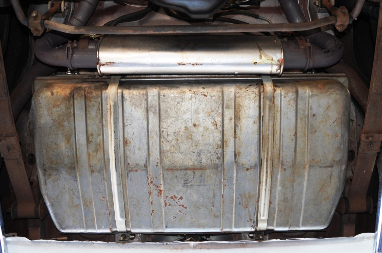

Is there overspray on the tank straps? If I recall correctly, they were installed and hanging when the car body went through the paint booth so the will have a strange overspray pattern. Here is the underside view of my untouched, white 73 SD455. You can see that the overspray comes from the sides of the car and a little from the rear

probably not enough steve... but there is some there...

Seen a few cars where the straps are the body color, based on having the Z21 option. Search the topics at Nasty Z28 as it was discussed in length a few years back.
