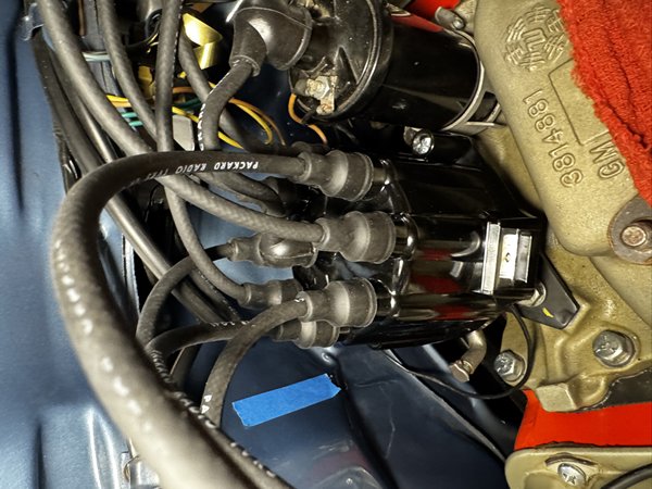

Distributor was put on a machine and gone through, new points installed and dwell set, made sure advance curve was working, and then everything lubed up. I installed a new Brillman brass contact cap and rotor and cleaned up and painted the cast iron housing. Got the distributor re-installed and put on a new set of dated reproduction wires while I was at it.

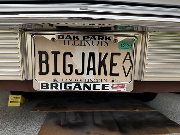

I thought a reproduction Brigance rear plate frame would be neat (not sure they ever made them) so I got one of those and installed it.

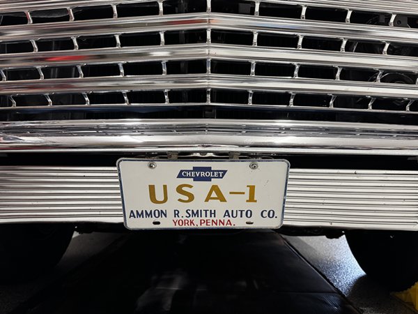

I was able to talk Tim out of the Ammon R. Smith plate he bought here last week and he was kind enough to let it go. Even though the car is from Brigance I thought it would be a neat period touch to have a real one on the front of the car.

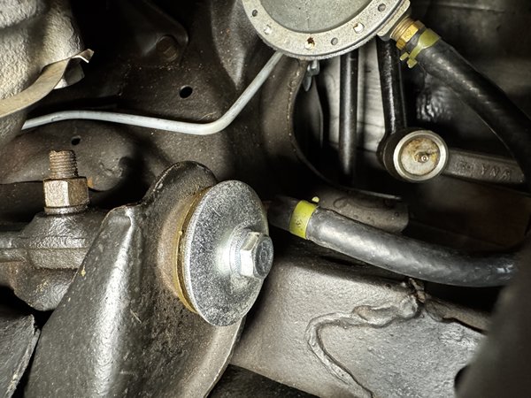

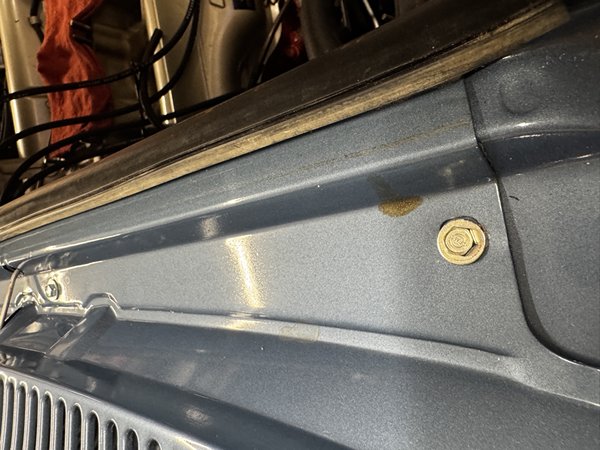

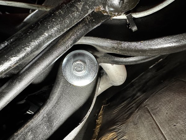

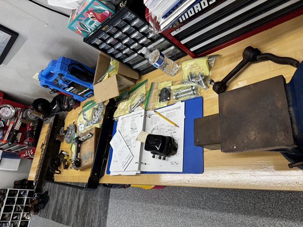

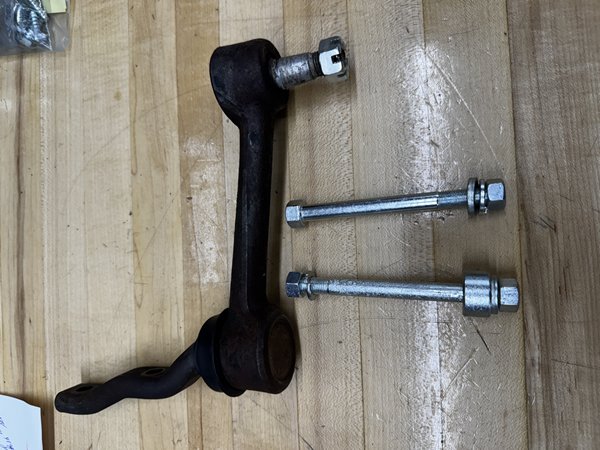

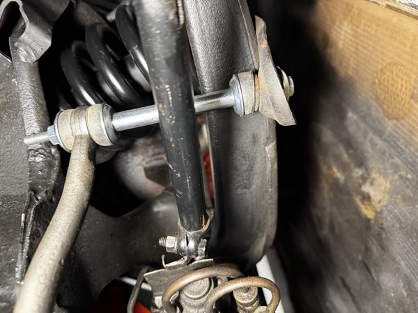

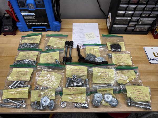

My original chassis and body hardware finally showed up yesterday so I spent some time last night with an air ratchet and started buzzing off the incorrect stuff and installing the correct stuff. Still need to swap out the front and rear bumper bolts, trans mount bolts, and front body bolts. Part of the fastener purchase was a good original idler arm and the correct fasteners for that.

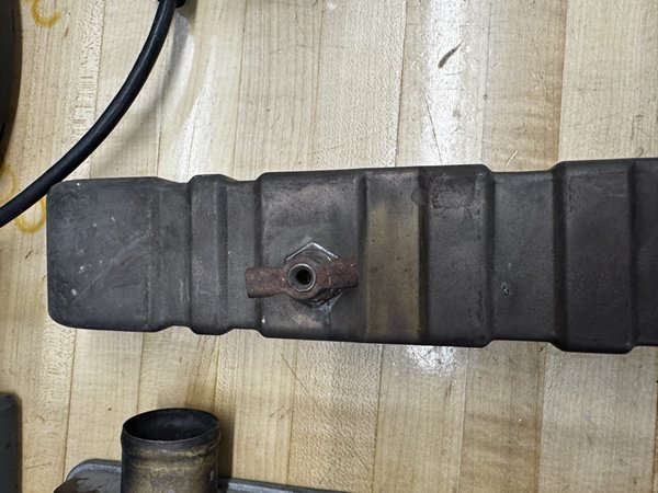

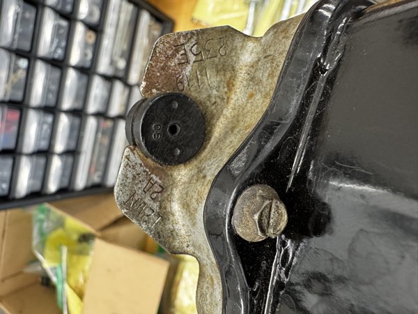

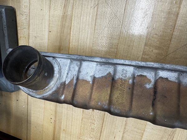

I was able to get a correct fan clutch, correct NOS idler arm (spare), an original idler pulley setup as removed from his car, correct upper and lower radiator tanks, an appropriate radiator strap (radiator shop can build the core around these parts) , and an impossible to find assembly line voltage regulator dated correctly for our car as removed from his car. Fan clutch and voltage regulator will be sent out for restoration.
