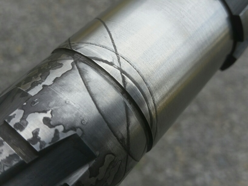

  #50
Old 12-13-2020, 02:34 PM
big gear head's Avatar
Join Date: Mar 2012
Location: KY
Posts: 3,371
Thanks: 5,604
Thanked 1,450 Times in 762 Posts
This Muncie main shaft was not completely submerged, and the Evaporust cut into it at the surface. You can see where I took it out a few times to look at it and put it back in in a different position.
Freddie
