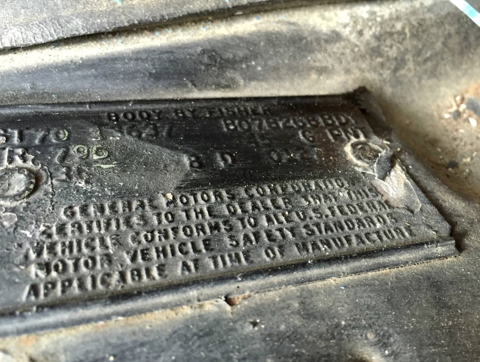

Default Fake car fake buildsheet “warning it’s a clone”
The build sheet body number is BB070260, trim tag has body number of B078268 this doesn’t happen and it has been listed in past by previous seller as a 396 years back when sold on racing junk . There is a big discussion about it on Facebook group for ls6 owners , the cats out the bag on this one, fake build sheet and a clone , truth be told

Default It’s not good
I contacted seller on ebay and showed him proof and he is still selling it listed as ls6 project , I’m guessing he bought it this way and doesn’t understand the buildsheet is fake and many other things, I hope he does change description or end listing...I have a way better picture of trim tag as well that clearly shows body number with 8’s instead of zero’s but I can’t figure out how to post pics

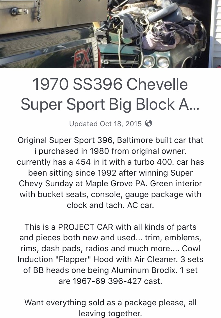

Model: Chevelle. Condition: Used. Mileage: 45000. Engine: 454. Location: 11952, Mattituck, New York. SellerID: shrekman2012. VIN#:, 136370b167139 .
Mileage doesnt match,but vin came up in an ebay search.

Default I’m wondering who cloned it
If it was sold from Maryland as a 396 ss to shrekman2012 and then was listed as a ls6 that may be who did the clone job and bought the horrible fake buildsheet with wrong body number , someone needs to put a stop to this nonsense of people cloning ls6’s !

This car was indeed an L34 that was cloned into an LS6 after it was sold by its longtime owner. The current seller probably got duped and is now left holding the bag.
