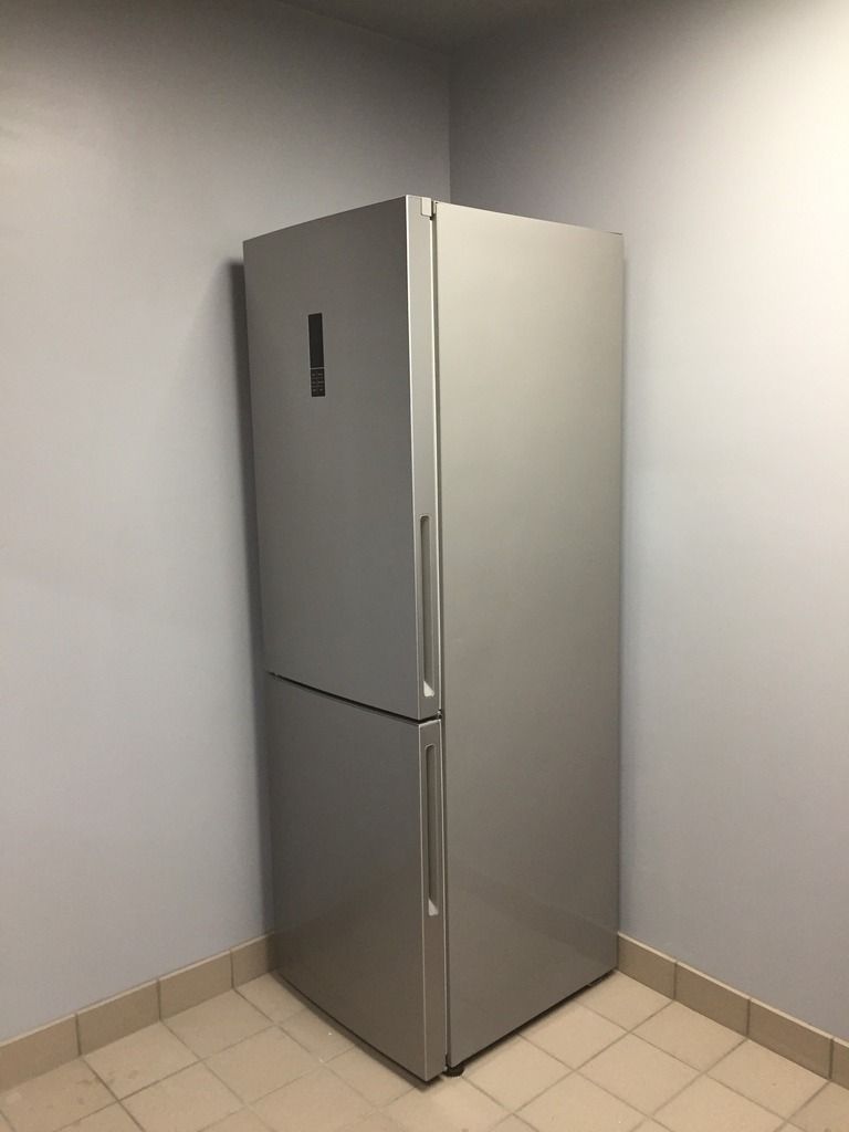

Once wetroom/bathroom was completed, we installed our fridge, lockers and sink.

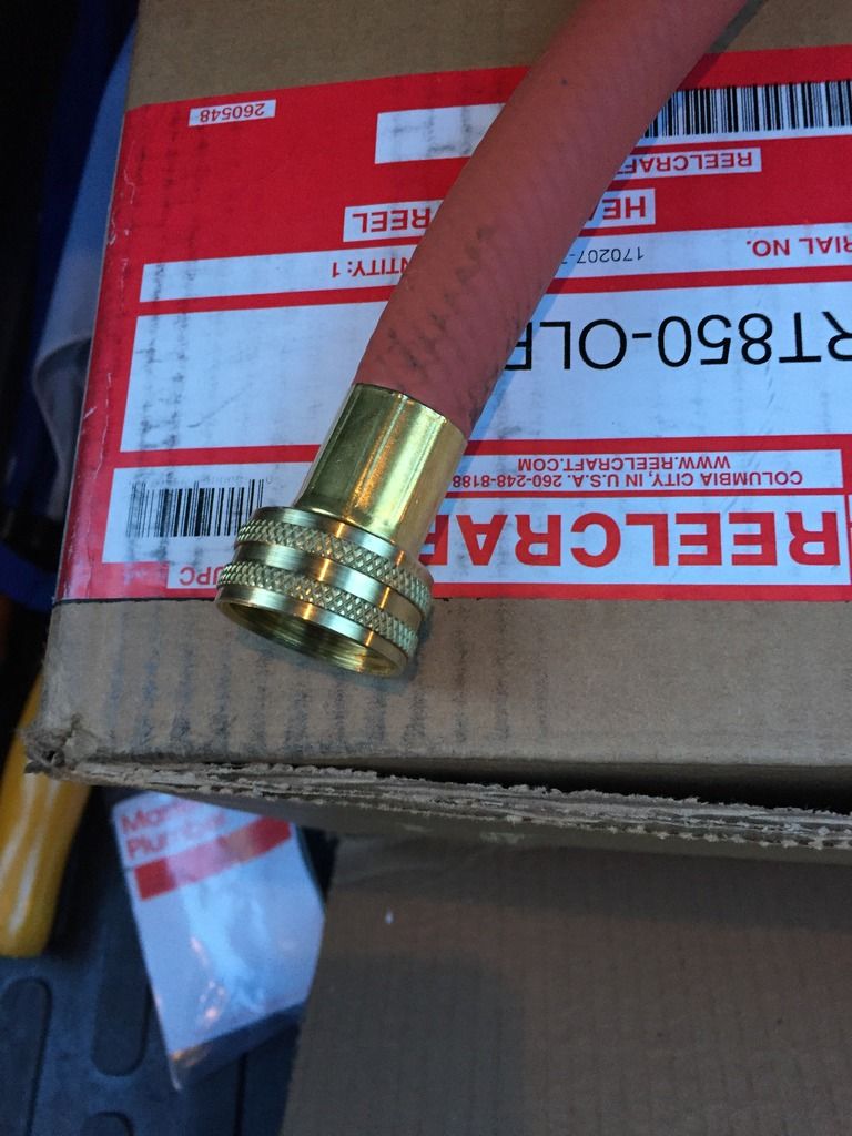

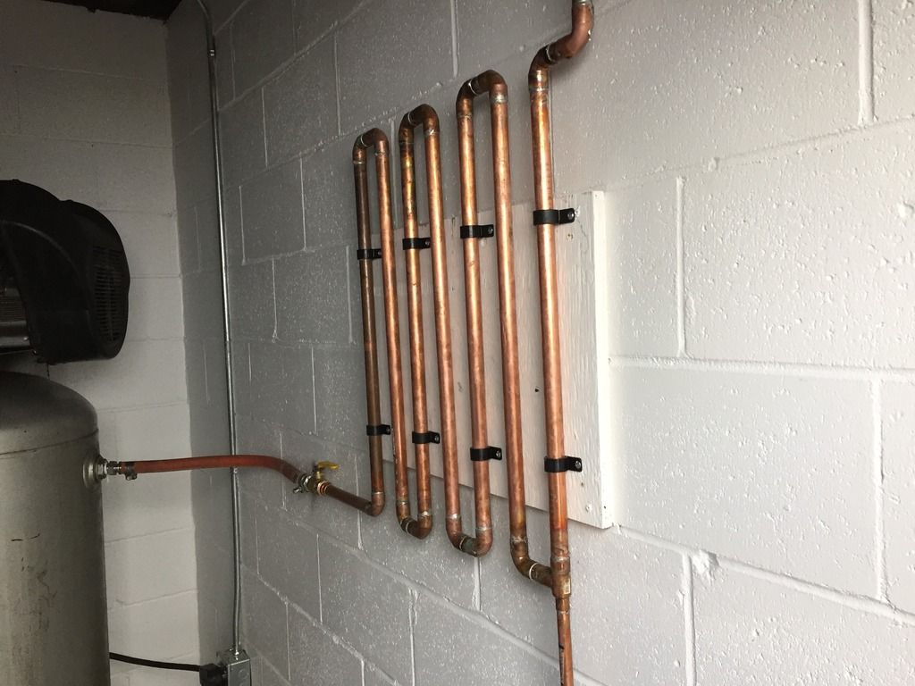

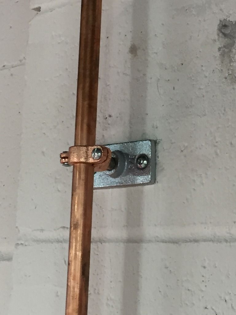

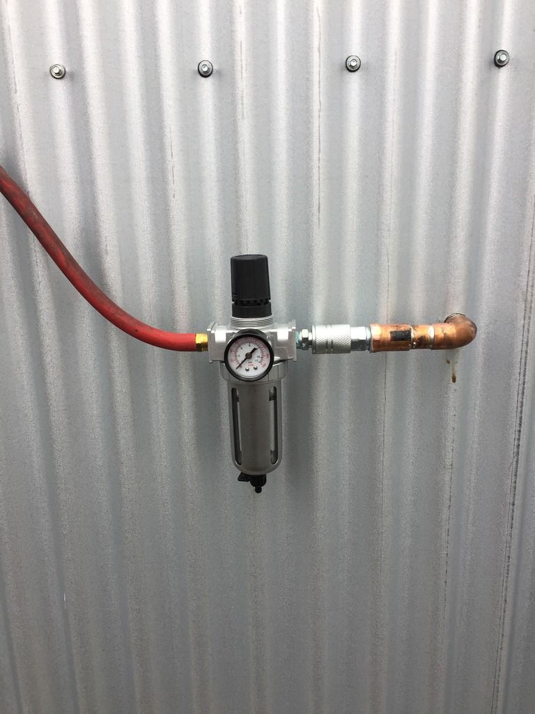

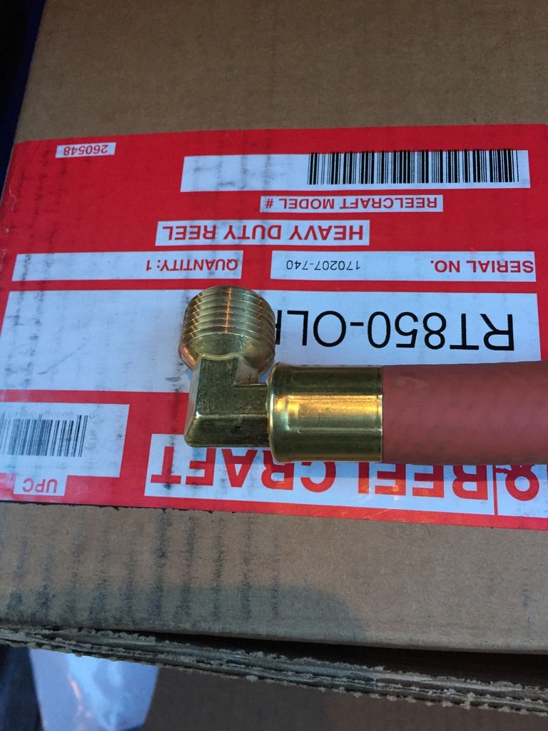

Borrowing an idea from Sam, I built a heat dispenser before air entered the shop.
We had to move the air 40 feet to the front of the shop, and 20 feet +- to either side, total copper pipe for air was over 200 feet.
Regulators were placed at every imaginable location with spares for future consideration, dedicated ones were put in for parts washer agitator and potential air jacks for hoists.
We had air hoses to reels custom made locallly.
And we used proper standoffs for secure and vibration fee pipes.
www.vancouverclassiccars.com

Ha, and I borrowed that idea from my hydraulic/pneumatic shop! Good for you!!
