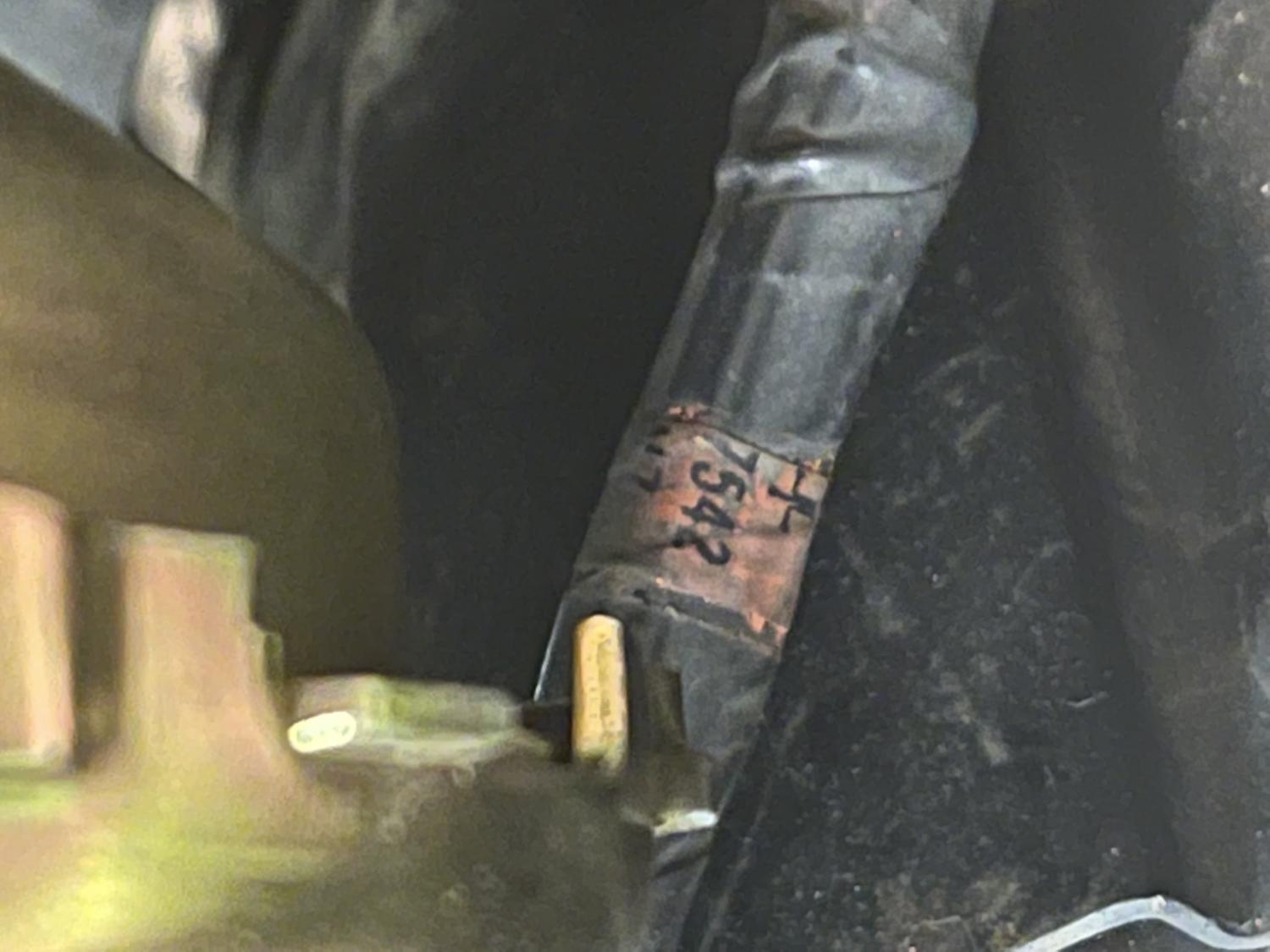

Wire harness tags
69Z X77 03D Lamans Blue
