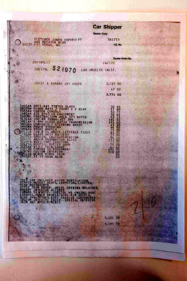

https://www.ebay.com/itm/16548354696...0AAOSwhC5igUXP
124379L521970
From the ad:
Up for sale is a very straight, solid, original SS Camaro. This is not a clone. It comes with the original build sheet and window sticker.
Paperwork is repro, as noted when it was on eBay September 2015. I'm certain Chevrolet would not misspell Los Angeles.

Heres the shipper report
Especially so, given that the car was built there!

2015 CRG thread also noted TT Body # different than fake paperwork.
Hard to believe how people spend $ like this without at least Googling the Vin?

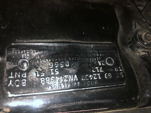

Looks like the guy at least amended the ad:
"I have had a couple of people state that the build sheet and window sticker that I have presented are not original. I was told when I purchased the car that they were original, appear to be so, and I have no reason to think otherwise. But no, I cannot definitely prove the sheets are original, but I am not intending any fraud here. I have described the car as accurately as I can and the car is an original SS big block car. I have a picture of the trim tag as well. Please contact me and I can send it if needed. Or contact me with any other questions."

The number 244988 on the tag establishes that the paperwork is fake; it should match factory paperwork. 361713 is from a much later car.
