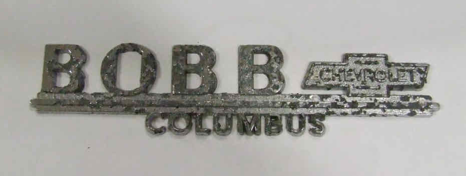

I like that shot of the pace car. Here is a photo of a '67 Z hillclimb car, a '67 A/Sedan road racer, both with Bobb sponsorship, and a Bobb dealership emblem.

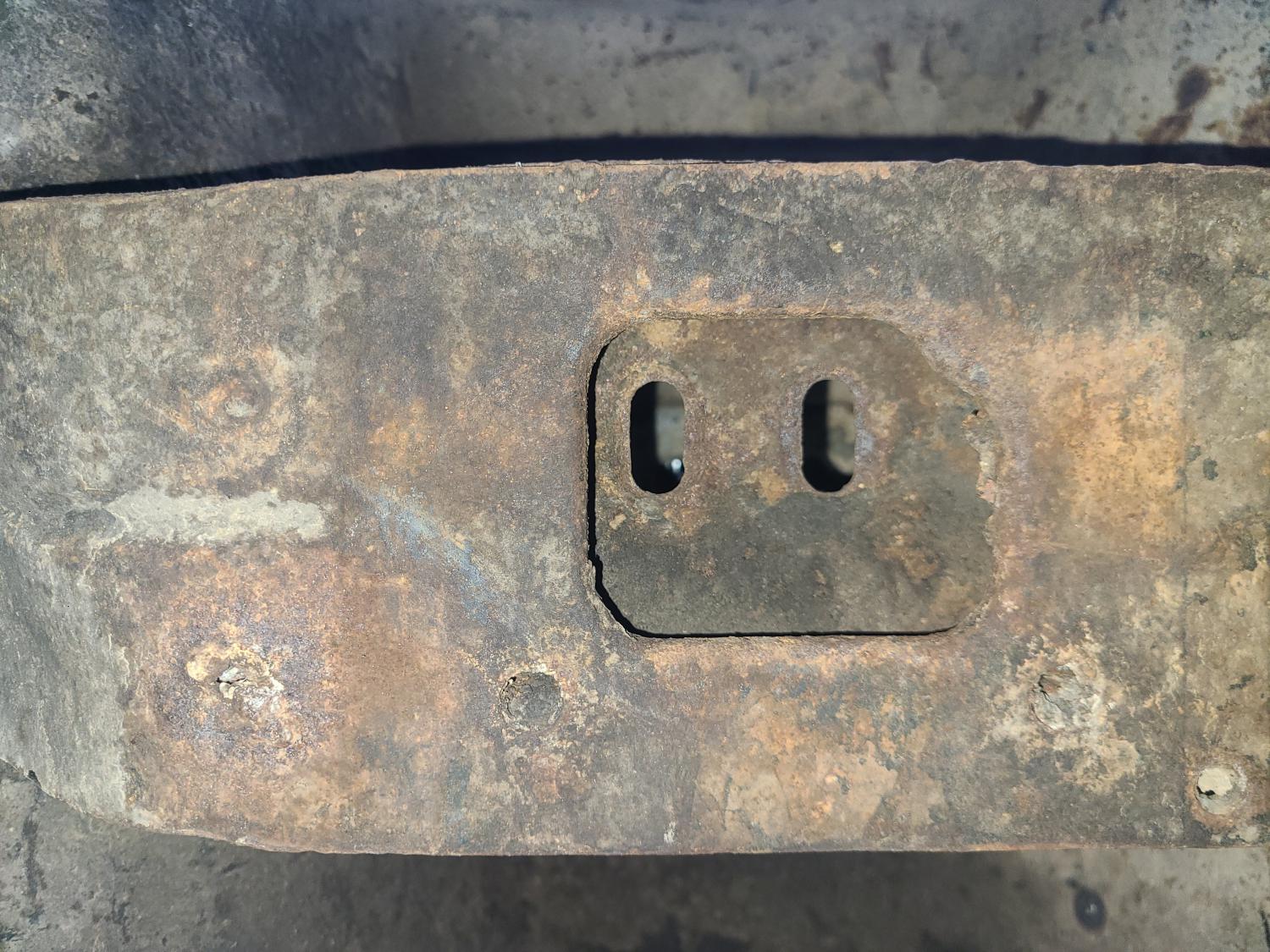

Here are a few more discoveries from the car:
I've discovered the front drum brakes are actually first gen Firebird.
The steering box/pitman arm is from a 1969 Z28.
Date B309B (I've seen one other box with the 8 misstamped as a "B")
Pitman 3953227
It's just under 4 turns lock to lock so my guess it's the standard Z28 box with mismatched steering arms/idler arm.
The crossmember/frame stands are correct for 67/68 396

At least you crossmember isn't a Firebird unit, looks almost identical to the BBC unit but the holes are in a different position.
