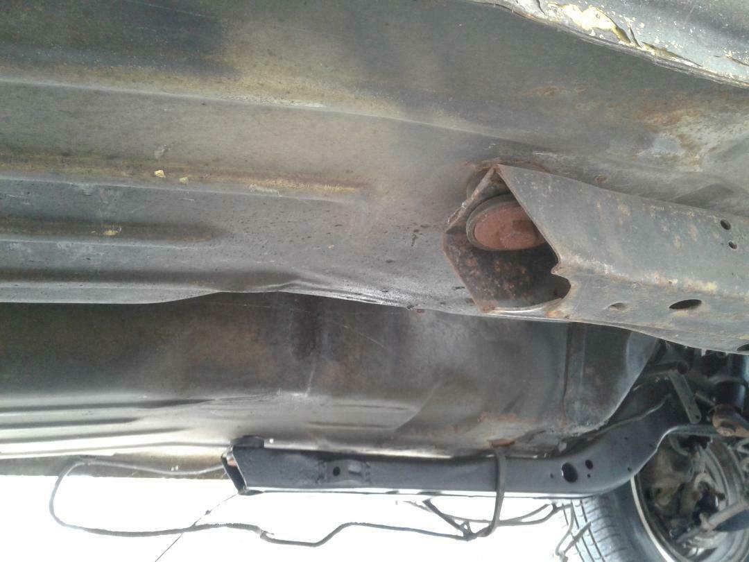

The original DY overspray can still be seen on the underside. I'll know more when it's here but I may try and save the underside.

Rear tail panel is in excellent shape. The car does not have much rust showing anywhere.
