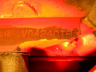

Engine stamp is fake, the "C" and especially the "B" are incorrect. I'd get a hold of Paul at Winvoices https://winvoices.com/index.php and see if he made the window sticker because he will place a watermark it.
Pic comparison here https://photos.app.goo.gl/F81AC6VxTggY8LMb9

The paperwork I typically see has a price listed next to every option at the time it’s written up. The bent trim tag seems unusual.

So the only real piece here is the cowl tag, sorry I don’t buy that. I also don’t like the way it looks either.
It definitely looks to be reinstalled!
