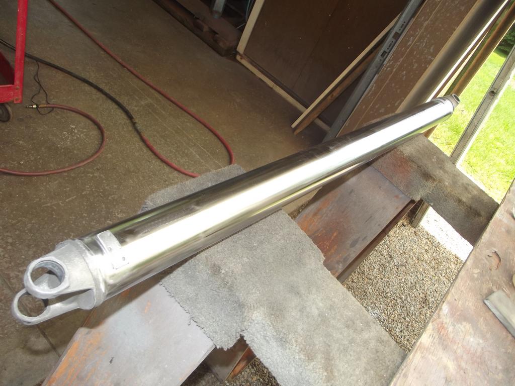

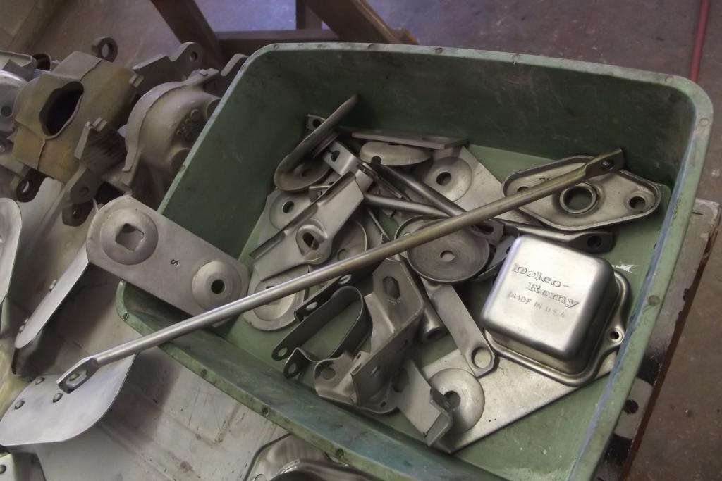

More resto stuff, evaporust, and RMP

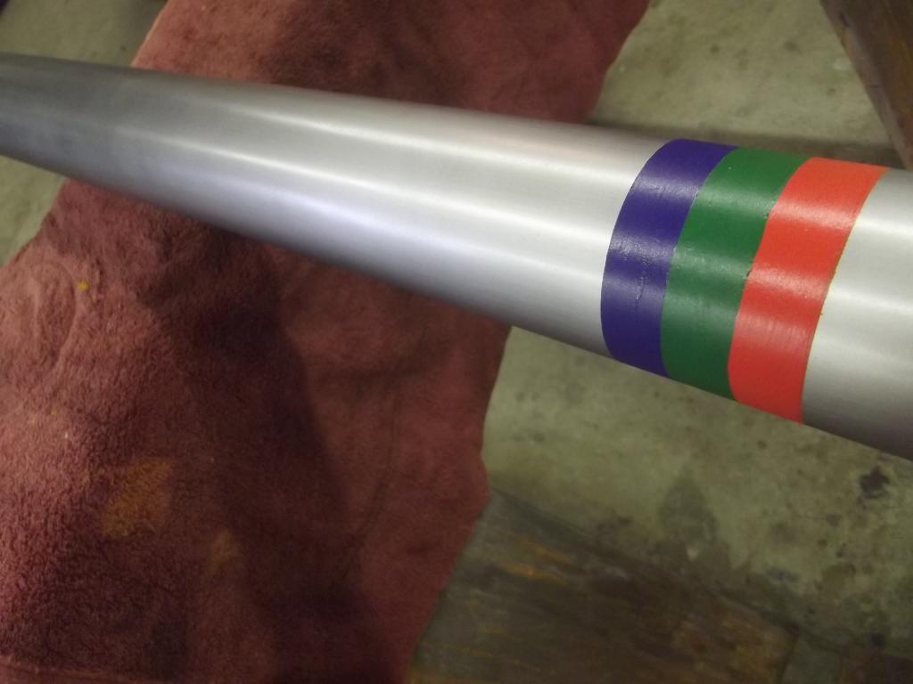

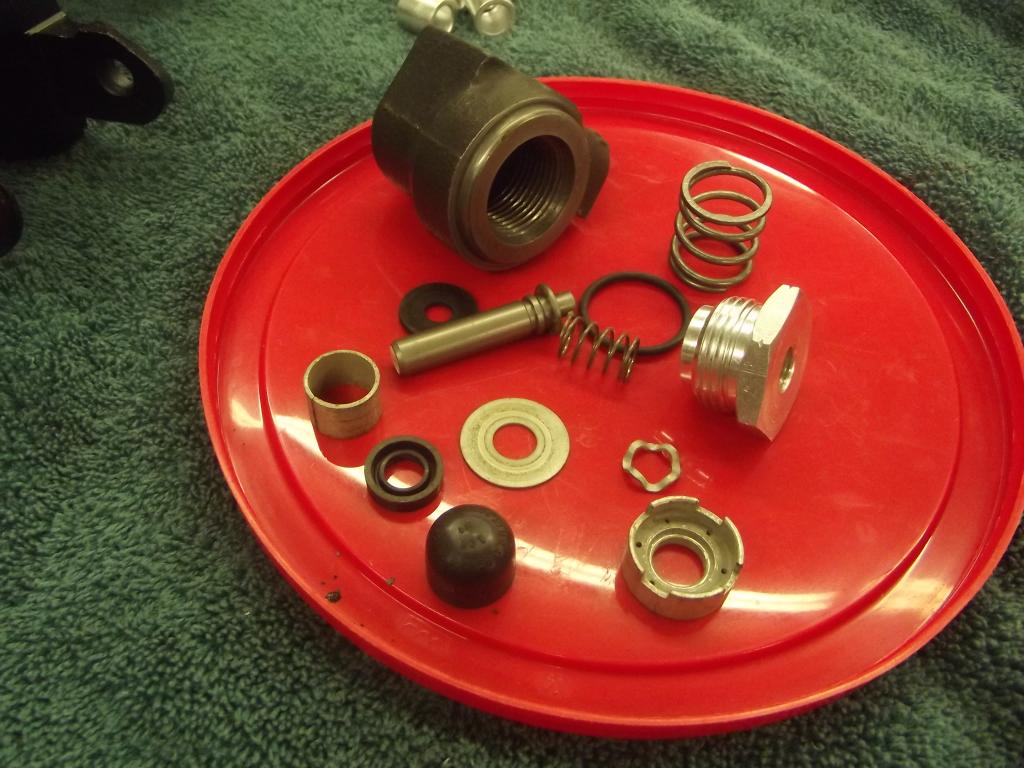

The drive shaft had no pitting and was fairly easy to clean up, we did not like the over polished look so I cleared it with some flattened PPG clear coat to give it a new metal look.

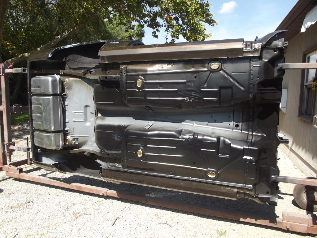

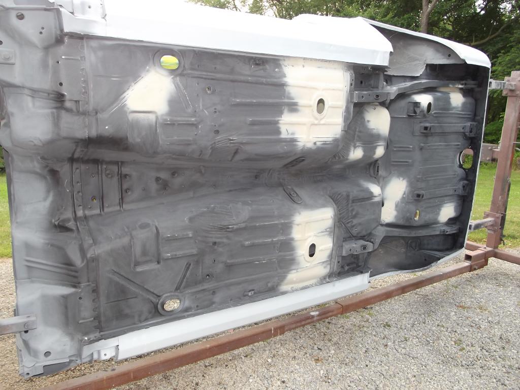

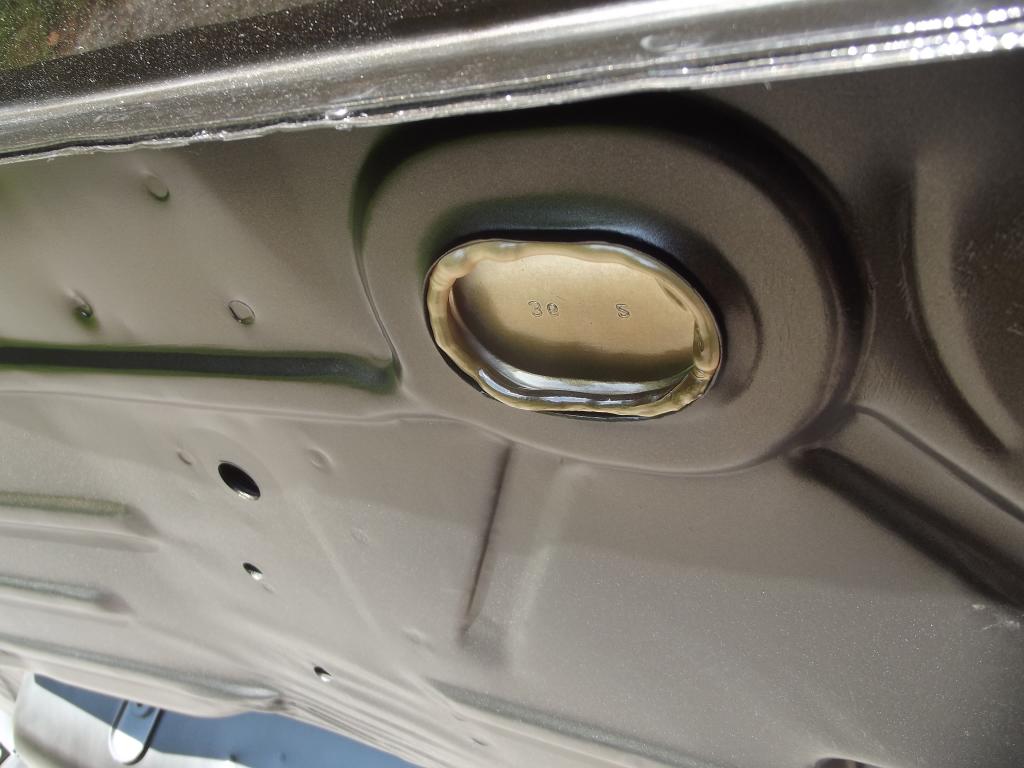

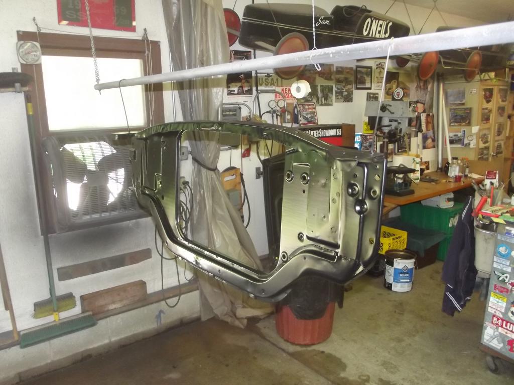

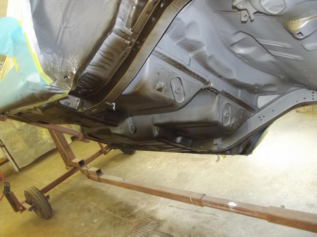

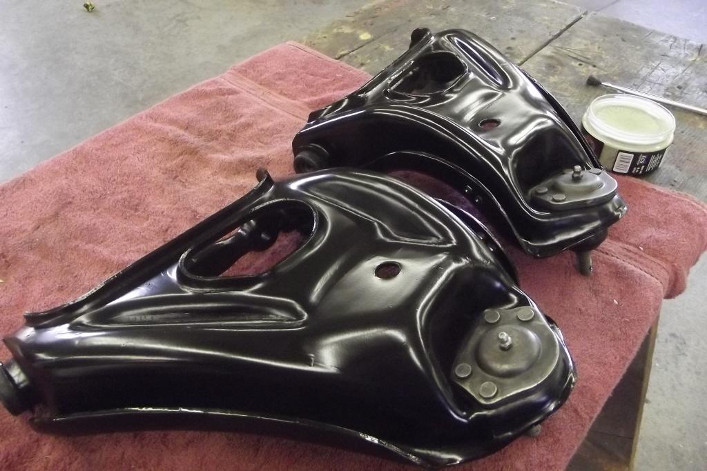

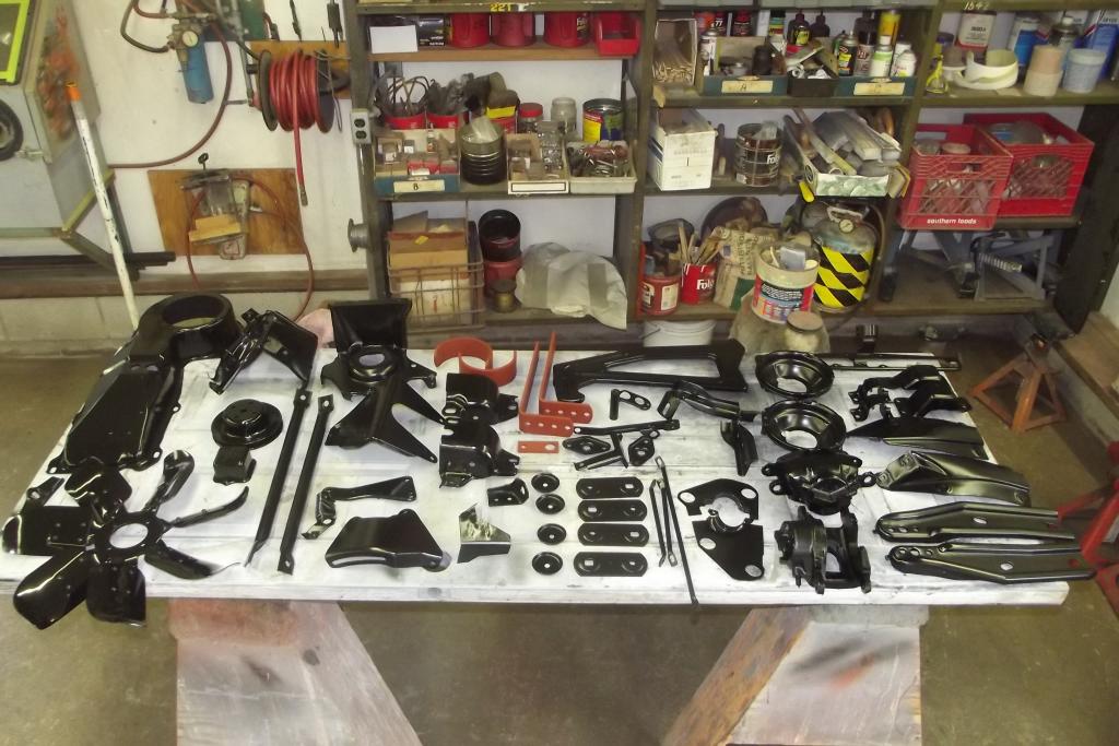

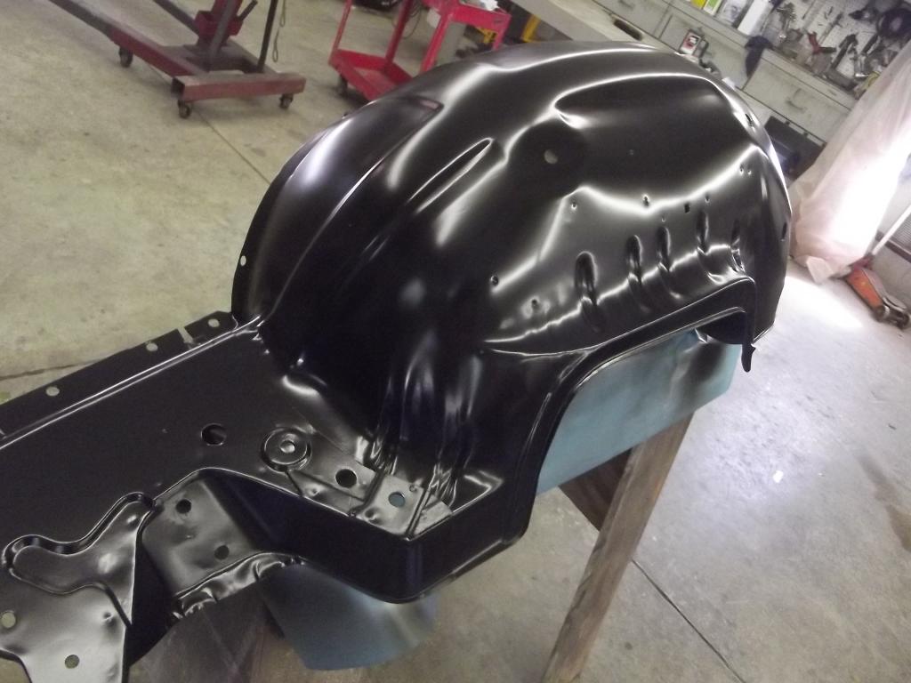

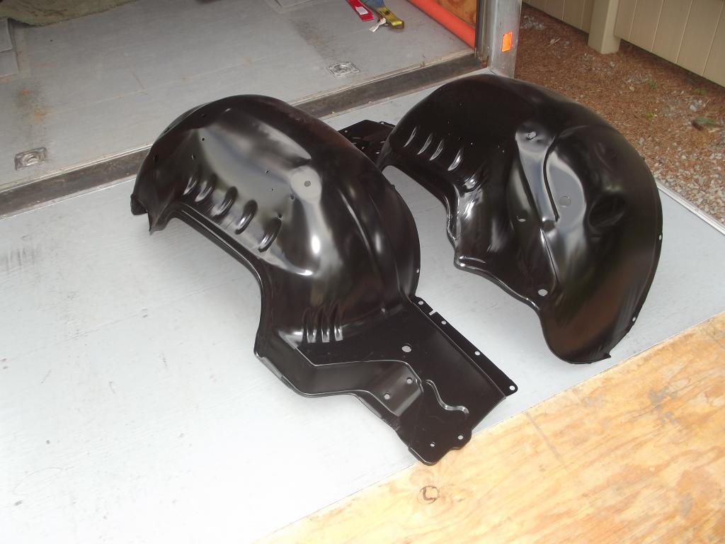

This black is PPG DP90LF black, finished in flattened black lacquer, I still like the look you get with this. On this build on some of the suspension parts and misc. brackets I have also used some PPG 2060 flex and flat clear over black base coat. It can be blended with other PPG clear to adjust the finish.
Floor pans with DP90 and some polyester primer as needed
On to the car
PPG DP40 epoxy
PPG DP40, reduced to flow, final gray
Lacquer blackout
Over spray detail, clear mixed with BB base coat, you not supposed to do that but it works [img]<<GRAEMLIN_URL>>/naughty.gif[/img]

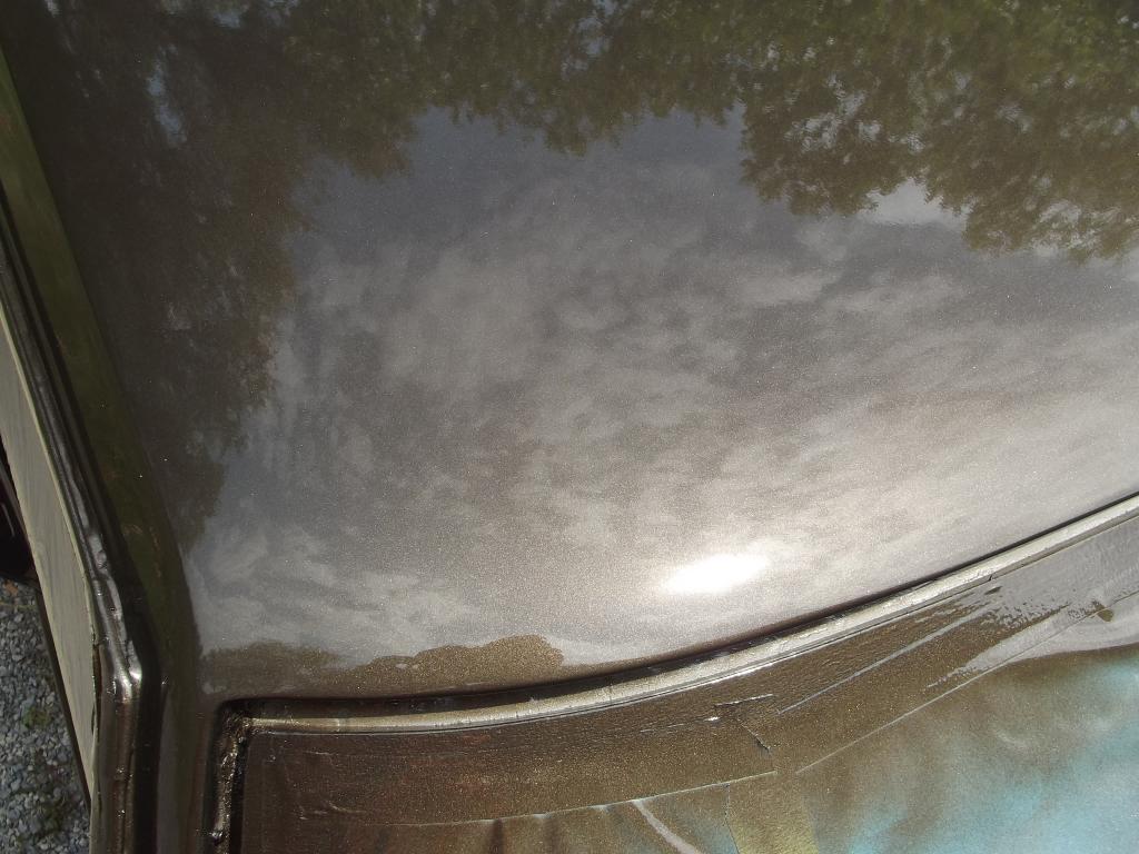

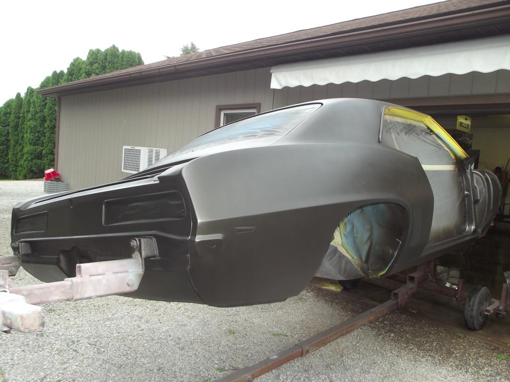

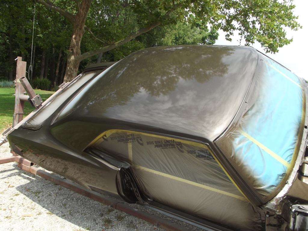

More body paint, first shot Burnished Brown PPG DBC base coat
Clear coat shots, and my helper 3yrs, and he goes to cruise in's with PaPa Mike, it's the best [img]<<GRAEMLIN_URL>>/grin.gif[/img]
