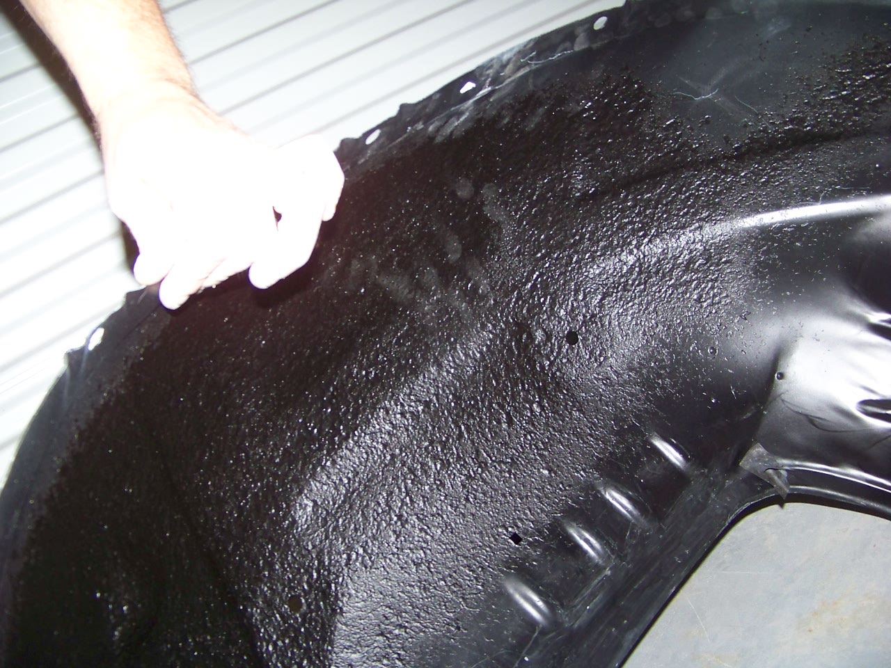

Here are some shots of the ashphalitic undercoating in the wheel wells and trunk. also the firewall and cowl with the PTB stamps.
There is so much light in the booth with the white on the horizontal it creates such a hotspot it's difficult to get how nice the transition mist is at the top of the cowl...
The PTB is a permanent heavy bodied ink, not paint.
