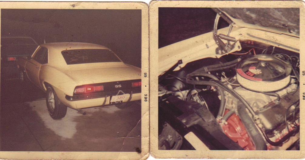

Any documented cars exist?
The 311 number that is floating around is the Camaro's number. I have a sense none were built, but if any exist, you guys would know.
So....Bueller?
