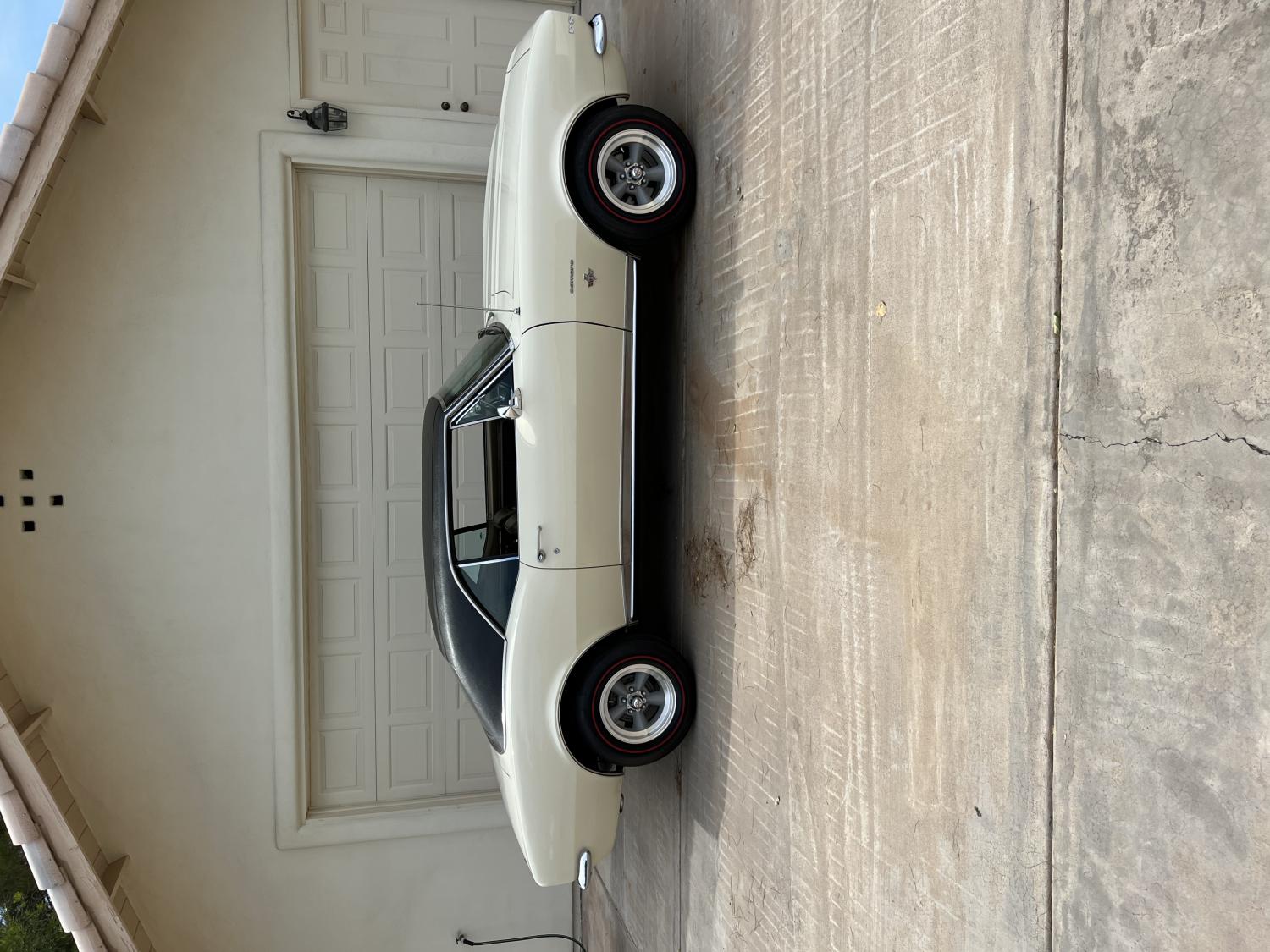

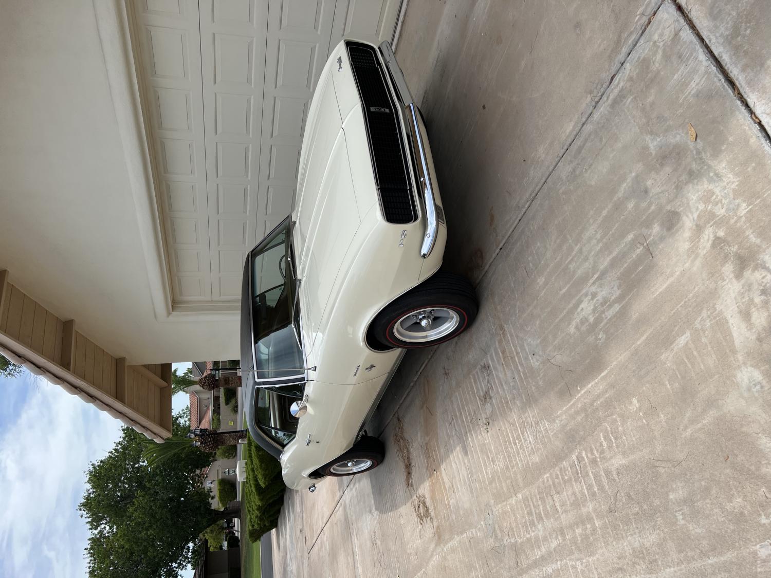

My 67 has 15X7 TTO’s front and back, standard 4.5” back space.
