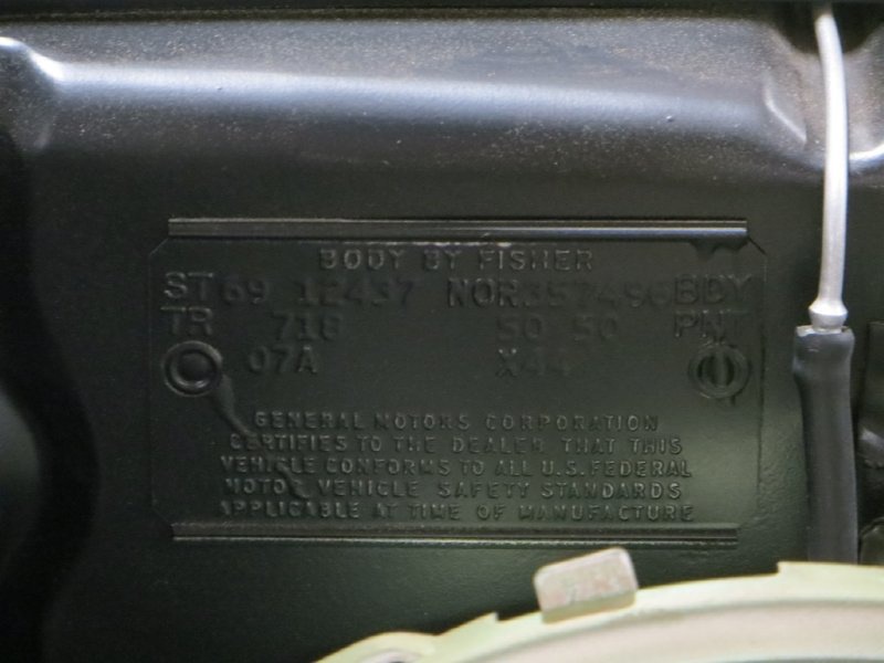

Curious why no D80 on TT for an 07A car?
What am I missing? Why should a non spoiler COPO have a spoiler designated on the trim tag? I believe some of the other Queens city COPOs were also non spoiler cars.
Calling JB resident Queen City Expert.

Of course, you are correct Stefano. I wasn't even paying attention to the pics after seeing the post about no D80.
