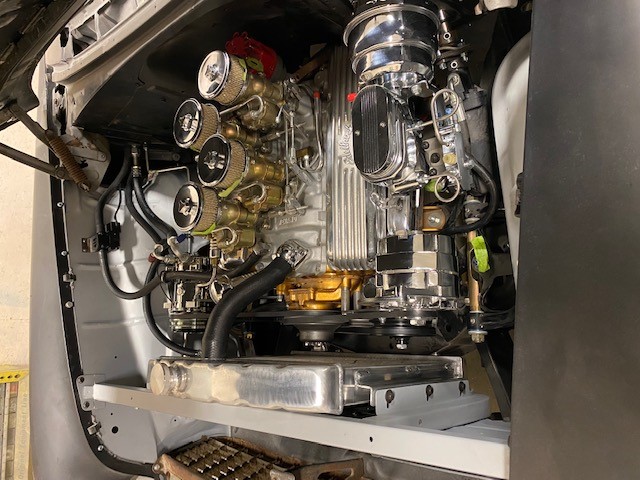

Engine bay just about finished being Mocked up

Tell us about the induction set up when you get a chance, Jason......Bill S

The induction is a Weiand WC4D 4x2 intake with holley 94 carbs. Its a very rare piece. I have only seen 2 in the last 10 years and I bought both. With the 2 I built a good set up for the 55 and sold the spare.
The WC4D is the only 4x2 intake that can be set up with progressive linkage. With progressive linkage you run off the center two carbs 90% of the time and the outer carbs come in about half throttle, with all four carbs coming to wide open throttle at the same time. I had a shop in Texas set up the linkage and rebuilt the carbs for me. I can't wait to fire it up.
I also have a vintage 6X2 Edelbrock intake I bought. Not sure what I'm going to do with that yet.
