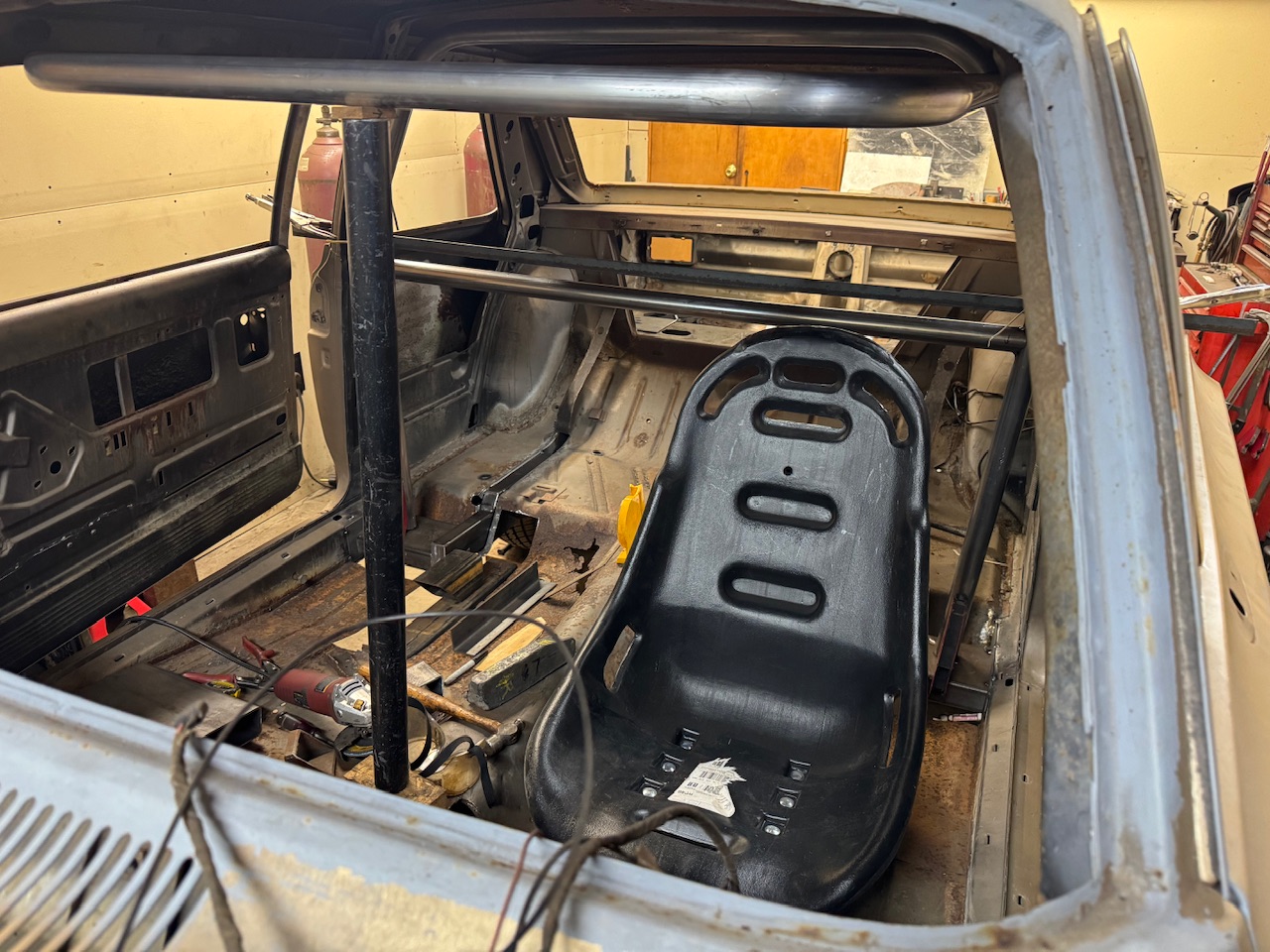

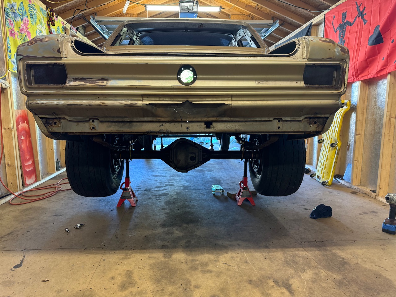

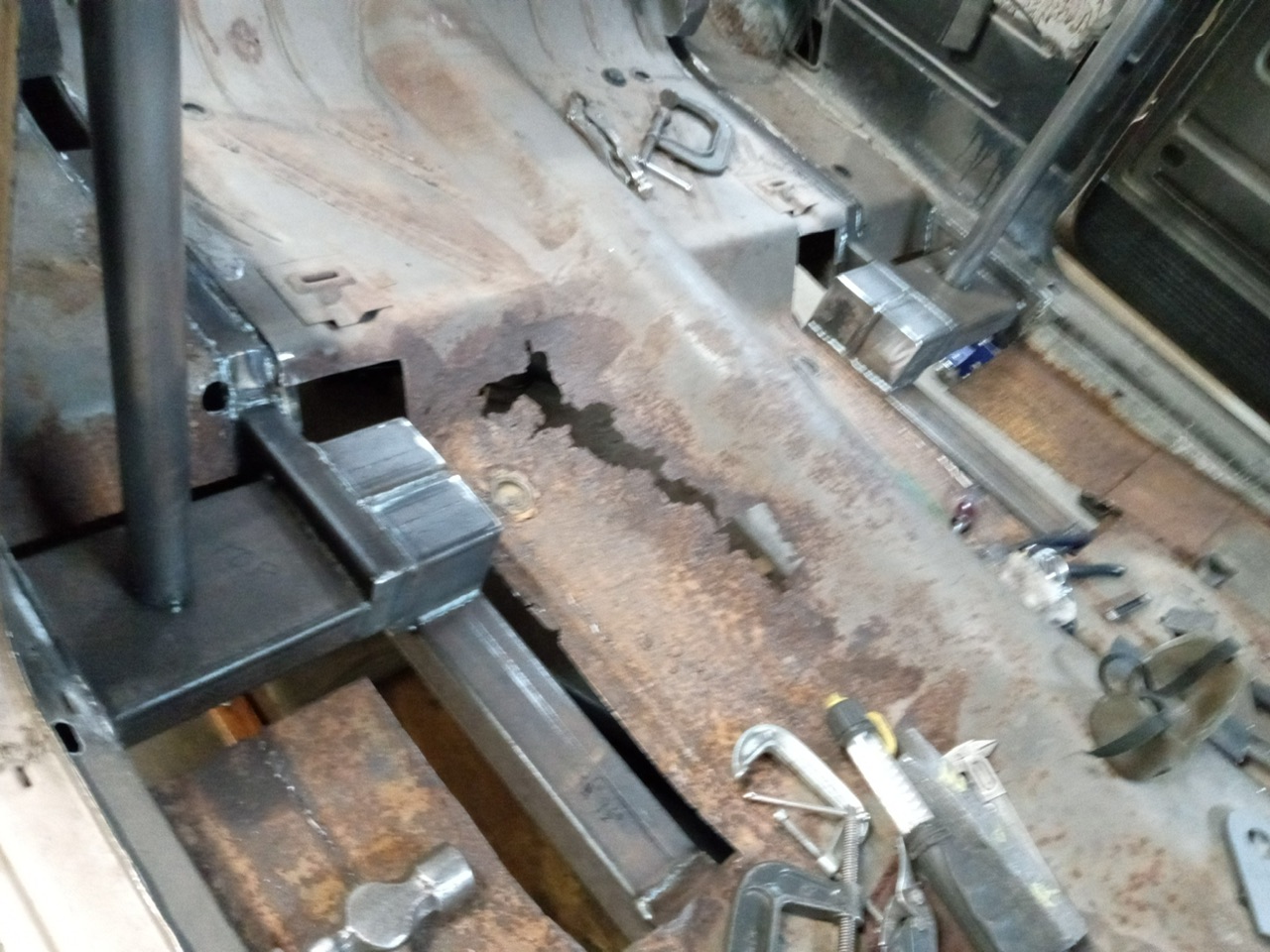

The rolling chassis went out to Pennsylvania the week of Thanksgiving for subframe connectors, cage install, steering column install, Ladder bars, and engine mount front and mid plates. He’s an older guy who works when he feels like it, I’m not in a hurry. He doesn’t have a cell phone so he sent me some picture today using his girlfriends phone.
I’m going up there around Christmas and new years so the cage can be set up around me and everything can be tacked into place. More pics in the future.

Took a 3 hour ride today to visit the car at Billys(the guy doing the chassis work). He’s taking his time and doing a nice job. He needed me there so we could see where the seat needed to be and test fit a few things. It’s funny I always go out there thinking we’re going to work on the car, but he wants to drive around and show me stuff. It’s fun so I can’t complain. And he’s being very very very fair with me for everything he’s doing. I’ll need to take a ride up there in a couple weeks to help him weld the cage in and start on the ladder bars.

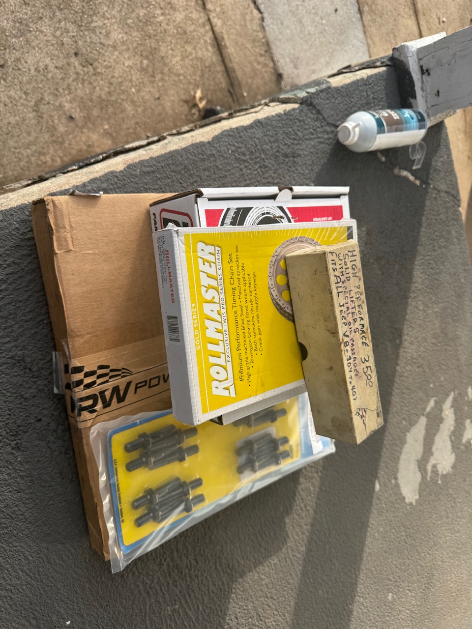

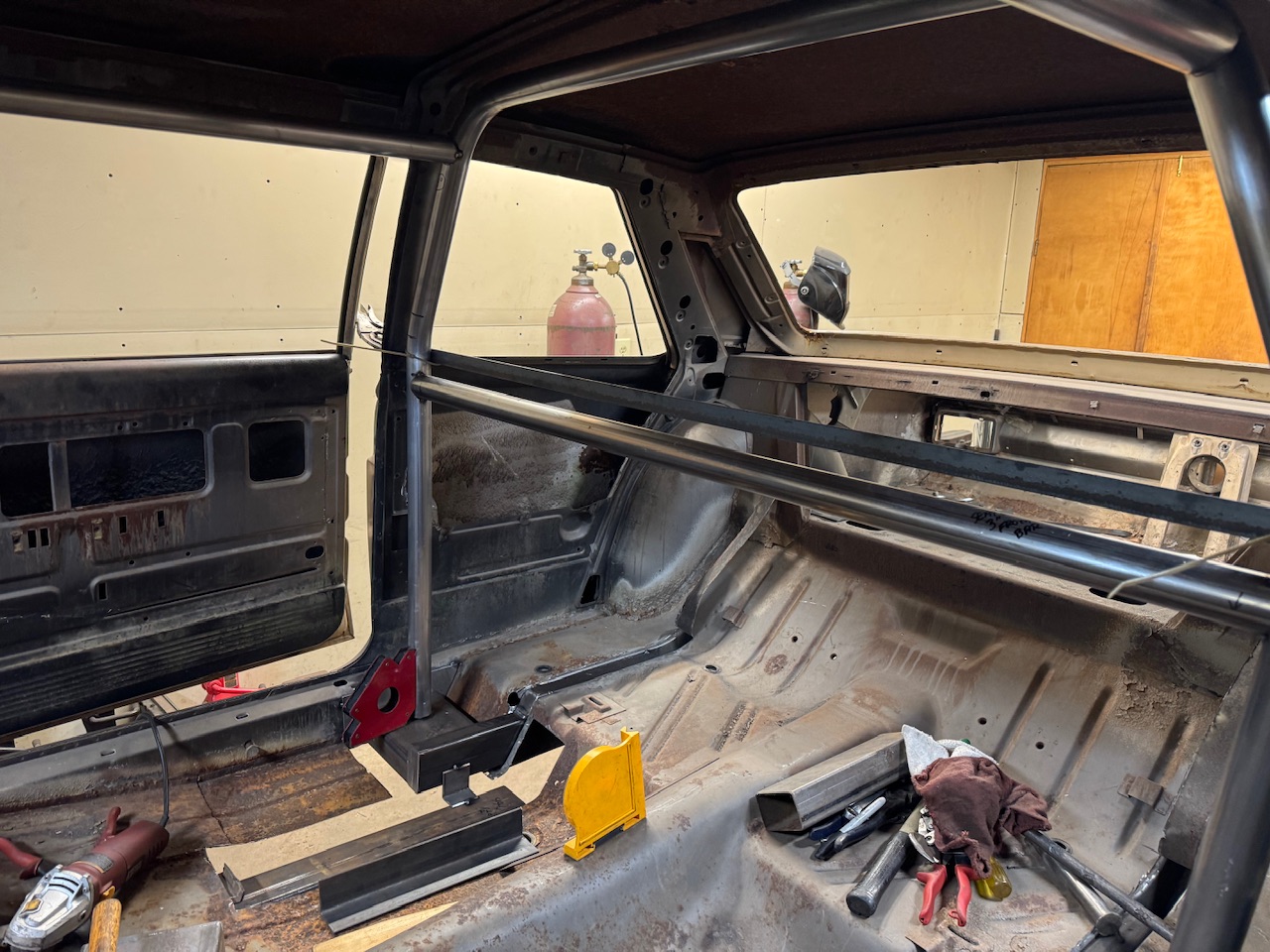

Small update from my buddy doing the cage and chassis work. I’m going up there next week to help him weld the cage in and start on the rear suspension. I might be picking up all the engine parts this weekend or sometime next week.

That's some beautiful work on that cage (IMO)
