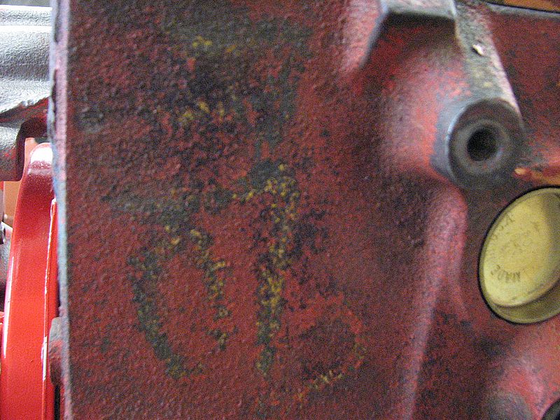

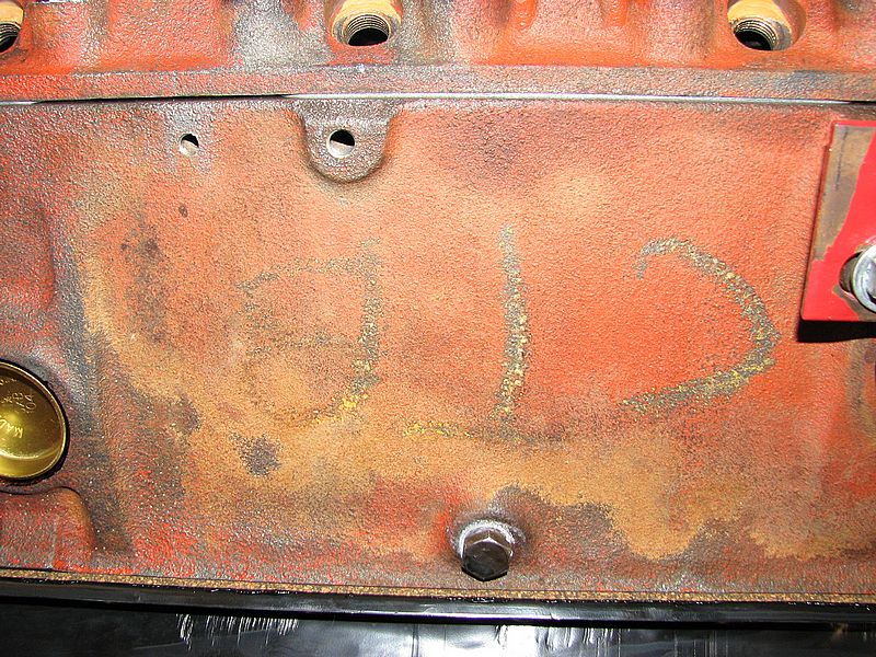

All inspection marks that I have ever seen were on the bare cast iron with rare exception. Depending on the type of applicator the paint often times did not stick to the inspection mark too well plus it is likely they were not always dry before the engine was painted. Here are some examples of engine assembly markings.
