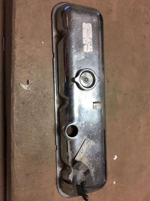

Can anybody I.D. this valve cover? Never seen one with that bracket near the rear of the cover. Thank you, Joe

1967 right or pass side with smog
Chevelle Camaro Nova and Impala with
The Dress up package.
Also Corvette same cover but never Chromed.
Joe

FWIW, when used for '67 Chevelle applications, L34 and L78 only, not L35. A rare cover!

California A.I.R Only

Thank you. I'll see what he wants to do with it...Joe

http://www.camaros.org/engine.shtml#bbcover
