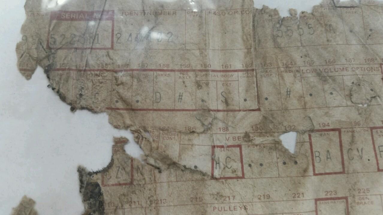

I am looking at this car, what can you tell me about the data plate? It seems funky

Los Angeles car. Not much to tell except paint, trim & date....Joe

Looks like an azure turquoise car with black interior.

Does anyone know what the F106 on the bottom right is?

Van Nuys plant, body scheduling code. Not really relevant to anything important

I have received more paperwork and pictures. Always looking for thought on this car.
The car is painted the wrong color currently, suppose to be a real deal 1969 z28 .
1969 z 28, factory original rare endura bumper . this is a cal. car . number matching engine and rear end. trans is a CE factory replacement. have broadcast sheet and pop. one re-paint in 1981. second owner had it from 1982-2016. car is a awesome driver quality rust free car. all original sheet metal, original interior. has some cracks in paint, mainly in the black stripe area. needs trunk gasket, door gaskets are original. dash pad is rolled up by windshield

That's a transferred warranty plate; no DT codes on it. Pretty much useless.
Block stamps may be ok, need to get the paint stripped off the pad. Also need pics of the carb, alternator, distributor, radiator. Each one would be $1000+ to correct. Rear axle?
Those are Corvette wheels w/incorrect tires; aftermarket rear antenna.
Figure about $20k to correct the paint, wheels, tires, dash pad.

So if that is the chassis broadcast sheet for this car, I see several codes listed that would indicate Z/28; Radiator, water pump pulley, alternator, front springs.
