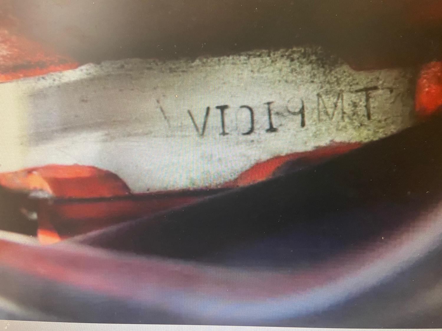

First generation cars have been bringing strong money on BAT.... but - this morning we saw a bid that jumped from $45k to $60k. Things that make you go "hmmmm".

I’d want a better pic of that trim tag…I don’t like it based on that pic.

Anyone care to comment on the engine stamp? Sure looks odd....

I dont like that engine stamp either. Its definately been altered.

An SS350 engine pad would have a partial VIN but the lower horsepower engines in '67 did not so I bet the last letter was altered.

Are the VIN tag rivets correct? Thought they were rosette shaped...or is that just certain Chevrolets?
Attachment 194755
----You are, of course correct, Bruce. That VIN has been off of that vehicle or maybe another. Weather it's the original to the car is up for grabs, but with the pad problems it's just a very nice looking 67 Camaro convert!......Bill S
