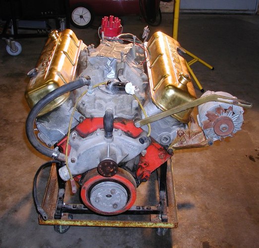

Here are pics of my 69 Camaro SS L-89 engine with one 842 head 3/69 and the other 5/69. No plugs in either end.
Paul

427king & Hotrodpaul,
Thank you for clearing this up. I certainly learned something! Is the exhaust valve face diameter 1.84"?

Here are some pictures of my 842's that are dated 8/68.
