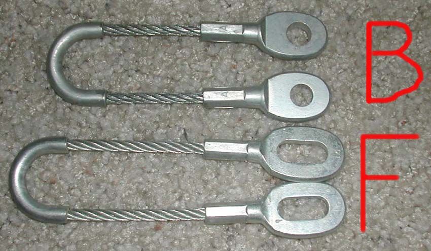

This was purchased about two months ago. Finally got around to test fitting it today. Bracket itself is fine and lines up with the manifold just right. However, the length of the one chain is not even close, even with the fat washers behind the bracket at the bolt holes. Seems this chain should be about 5 3/4" rather than 5". This is for a 69 Chevelle BB.
Were there various lengths of these chains for different applications? Wonder if this chain got swapped out at some point over the years.
Any help would be appreciated. Thanks.

Bill Rose contacted me and said he had to loosen the shaft, etc. in order to get his to fit. He sent me some pictures and it is really snug.
I contacted Greg Cullum and Dan Vasic last night and they sent me these pictures. My setup is #325875 which is apparently not correct for a Chevelle, it should be #320266. The correct cable is in fact about 1/2 inch longer and the holes are &quot;elongated&quot; as well. At this point I will take their word for it.

Don...I'm no expert on this but in my search for a kit for my 69 Nova BB I'm told I need PN 330266.
325878 is for SB Camaro, Nova, Chevelle
325875 is for BB Chevelle, Impala.
Someone else chime in if this is not correct !

the ones that DON'T say for Camaro or Nova are for the Impala / B body Chevys. They never made a kit for the Chevelle as they had a cable throttle that did not stick. The reason no makes are stated on the instructions and box is because it is for all big cars, no others. They DID make kits for trucks and vans as well.
I have a picture of the two BB kits side by side and the ONLY difference is the length of one cable ... will try to dig up the photo and post it.
I thought this had been discussed recently, the search function got it:
https://www.yenko.net/ubbthreads/ubbt...047&amp;page=2
http://i8.photobucket.com/albums/a26...1z/bbvsbb2.jpg
http://i8.photobucket.com/albums/a26...1z/bbvsbb3.jpg
