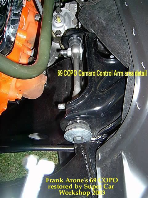

http://img.photobucket.com/albums/v4...Crossshaft.jpg
One of the BEST possible examples.......albeit this is Frank Arone's 69 COPO Camaro

Thanks for the picture. Are the control arms supposed to be the same 60% gloss as the frame? Also, did you guys install all of the bushings/balljoints before or after painting? Do you put any special coating on the bare metal shafts and bushings to keep them from surface rusting?

Control arms are normally a little more glossier then the frame. I install the bushings before I paint the control arms and just mask them real well so as not to damage them trying to install on painted A-arms. Upper ball joints go in after painting. I seal all my unpainted surfaces with Boe-Shield.

Control arms are supposed to be 30% Glossy (according to Jerry M's book)

The Novas upper shafts are believed to have come black, because the control arm was painted as an assy sans ball joint. The large upper bushing washers are also supposed to be black on Novas. This per Wayne Bushey and the '70 L78 Giveaway car resto project.
