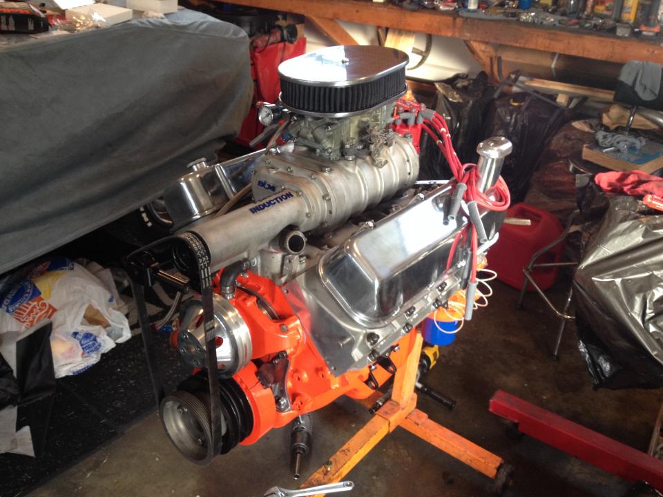

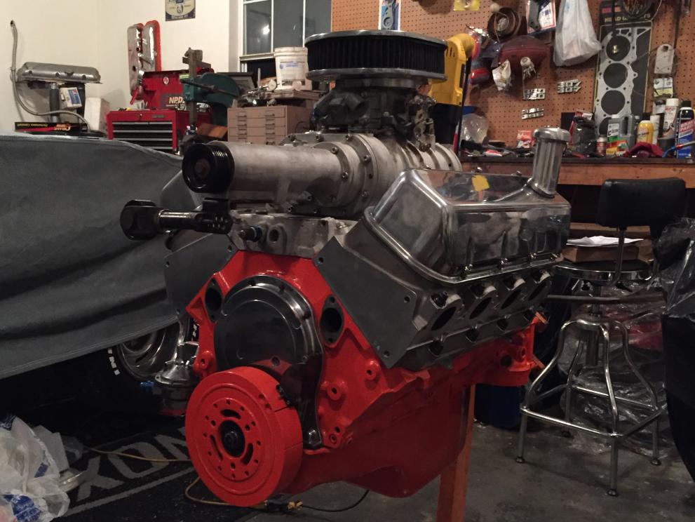

I have had a couple more engines come into the shop over the past few weeks.. Updates will be as I am done with them.. May have to change the RGR from Red Gorilla Restorations to Red Gorilla Racing.. [img]<<GRAEMLIN_URL>>/rolleyes.gif[/img] Im kidding of course since this is just a side hobby..
First is a 469ci BBC with a B&amp;M mini blower.

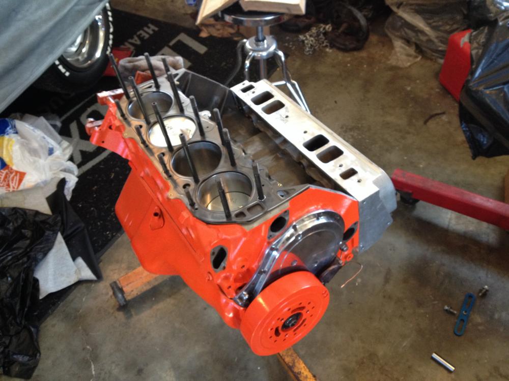

<span style="font-weight: bold">LS1 cleaned and ready for assembly. Next will be applying the micro slick coating to the bearings &amp; piston skirts along with piston top coat to the tops of the pistons.</span>
<span style="font-weight: bold">The big block heads to the machine shop on friday.</span>

I see you Scotchbrited / wire wheeled the deck surface on the BB. I have never touched the deck surface when I rebuild my motors. Do you believe it is necessary?
Old 07-02-2015, 02:03 AM
cook_dw's Avatar
cook_dw cook_dw is offline
Join Date: Oct 2003
Posts: 4,388
Thanks: 672
Default Re: Couple new Engines in the Garage
Its out of habit. I use a scotchbrite disc on a 4&quot; angle grinder. I always do it to get a clean surface so I can lay a straight edge on the deck surface to verify its true. If its not then its added to items to be done when at the machine shop.
