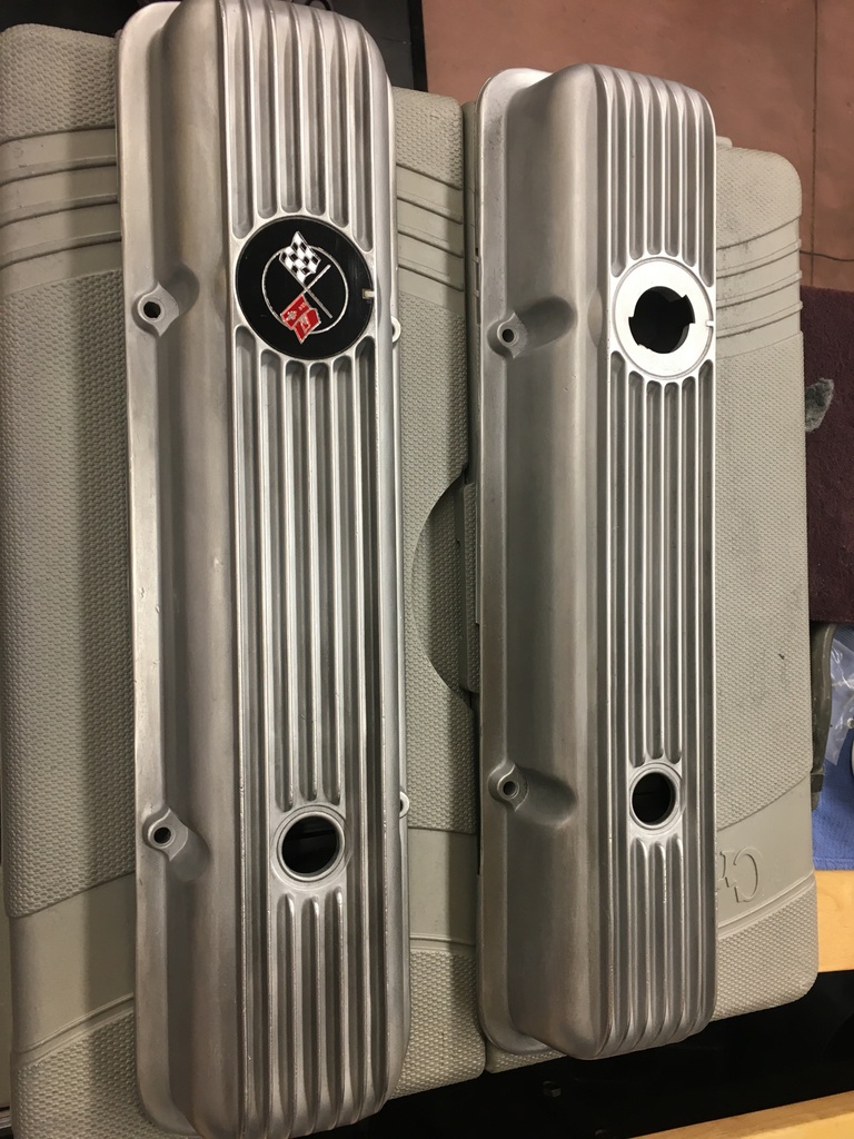

Did mine by lightly blasting with low pressure glass beads then 0000 steel wool to put a light shine in the peaks of the fins to put a very light shine on the flat surfaces. Had to do it twice to get it where I wanted. The key is to not rough it too much in the blast cabinet. I used about 40 psi, just enough to pick up the media and stayed about 8 inches away from it. Just enough really to clean the surface and even out the surface.
I then followed up with the satin finish Ever-Brite to seal the pores and make them easy to keep clean.

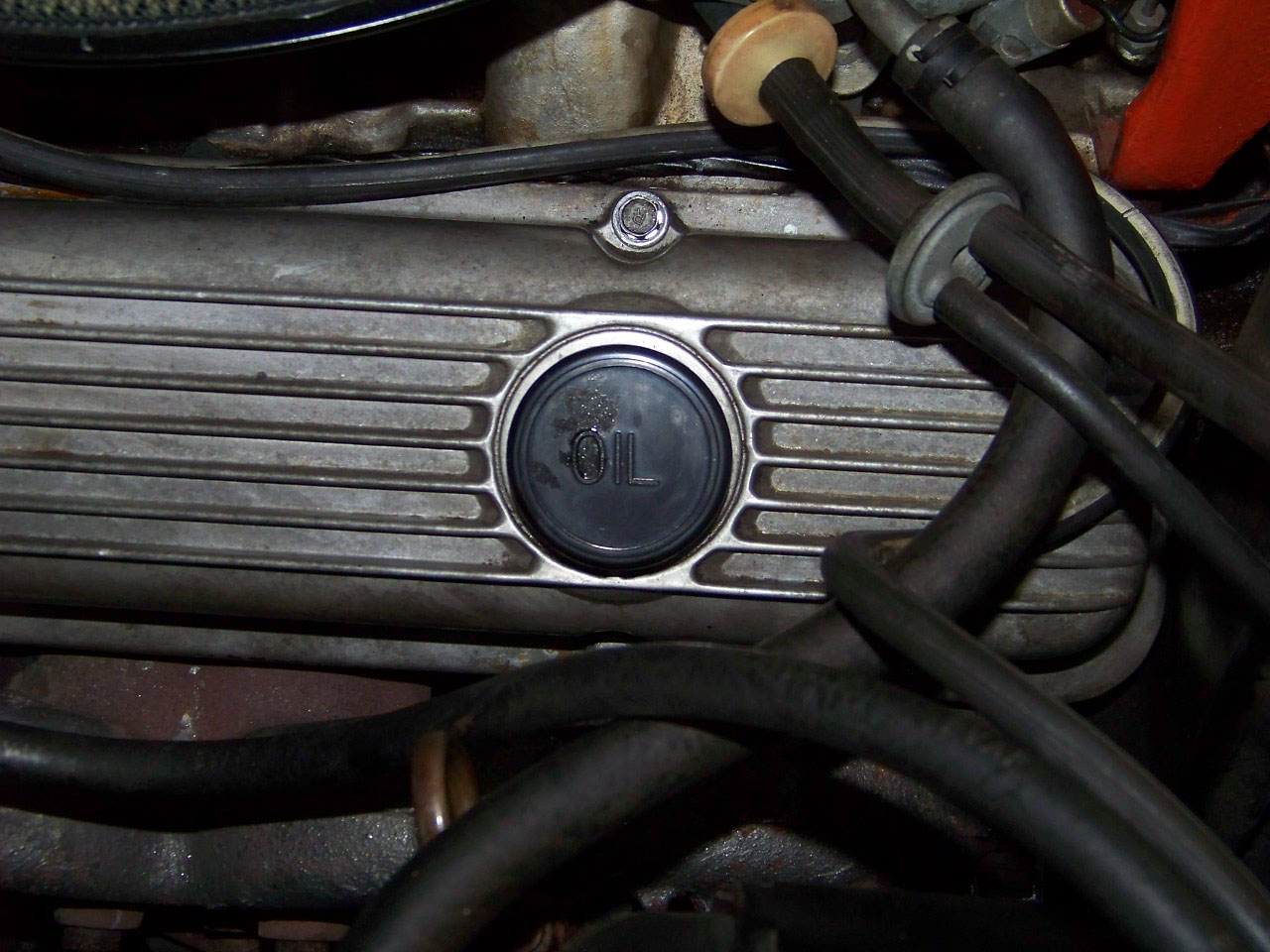

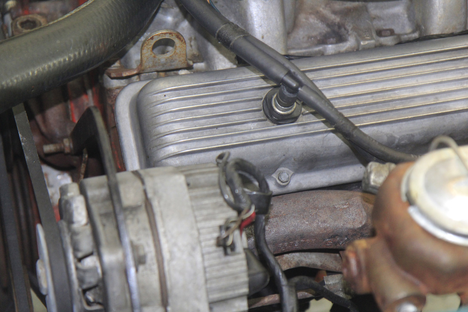

I recently cleaned up the valve covers for my 71 LT1. I feel like they look right as far as the finish color etc.
I used organic PH neutral cleaner then used neverdull cotton wadding, however they were not too dirty when I started....
The FIRST PHOTO IS FINISHED
TWO SECOND PHOTOS ARE PRIOR TO CLEANING.
