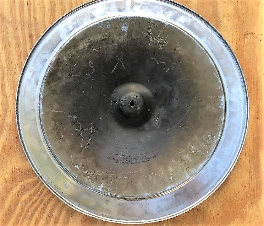

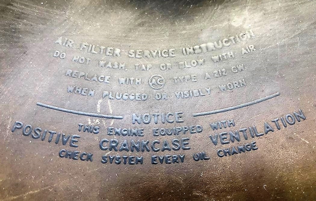

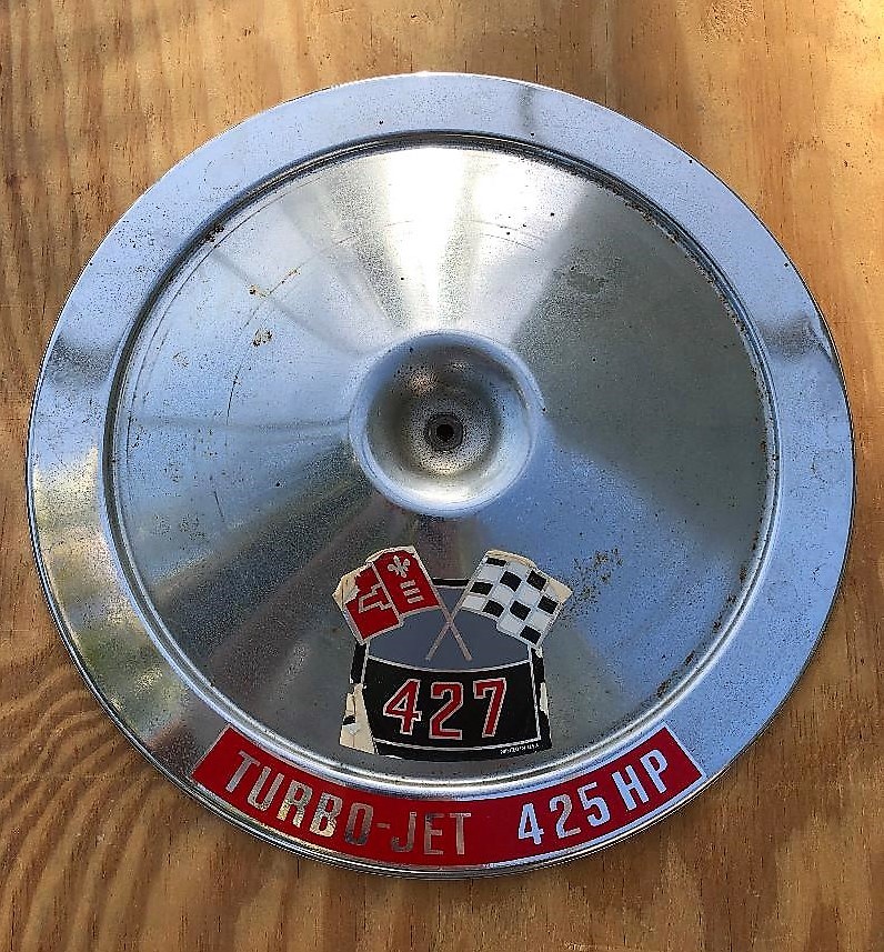

Hello Guys,
I've been researching if it's possible to have the upper side only re-chromed on air cleaner lids? I recently purchased an original '66 Corvette 427 survivor lid that has a very nice underside AC instruction silk screen that I want to protect.
Does anyone have contact info of platers that will do this job? Any testimonials of work done? I've been told that this process is possible.
Here's the subject lid. Mike
