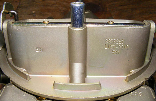

Several years ago I restored a 3130 for one of Dave's cars, but I don't have the paperwork on that job handy so I can't tell you what the date was on that particular carb. I do believe he intended to use that carburetor temporarily while he attempted to track down an original 3310, which he finally did do. Perhaps the 3310 never found its way under the hood, I don't know.
For the record:
3130 = B body
3124 = Corvette
3310 = Chevelle Z16
Hope that helps.
Eric

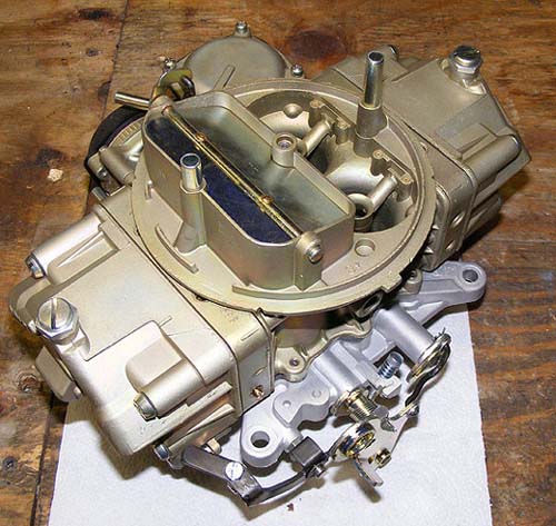

Here's a pic of the 3130. (still don't know what the date was)

Here's the 531 dated 3310 I restored for Dave--as it arrived to me.
