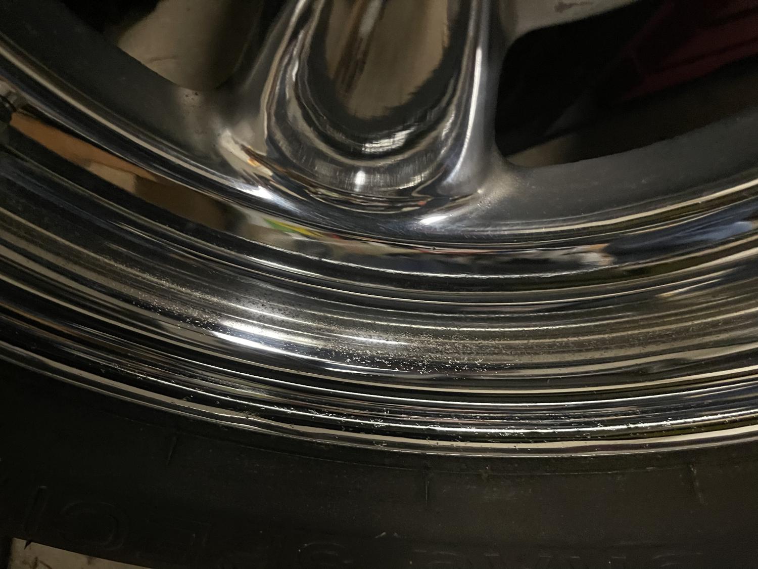

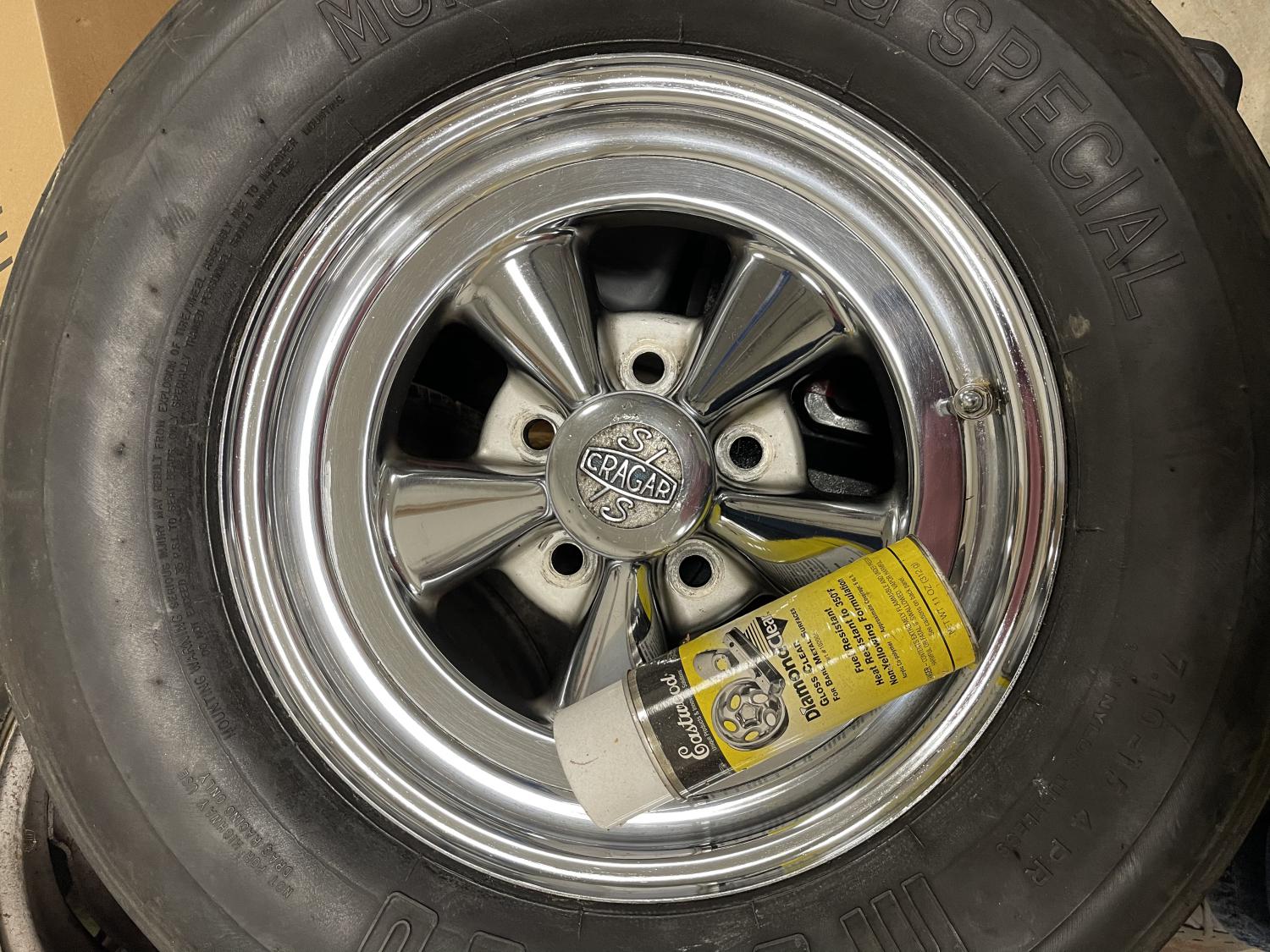

Looking for someone to rechrome a pair of Cragar SS wheels. Has anyone had this done that can provide a recommendation?

For now I have to use the wheels as is. Anyone have any suggestions for cleaning the chrome? I was going to go at it with 000 steel wool. The wheels are pretty good other than right by the lug holes.

paint around the lugs with alumina blast from eastwood...
I would not use the steel wool because if you get even one tiny piece of chrome braking off and caught in the steel wool, you will just create a ton of new scratches in the existing chrome. I ended up using Simichrome chrome polish and a lot of fluffy, towels to capture any tiny pieces of chrome flakes.
If you go here you can see what I did with my 1970 set:
https://www.yenko.net/ubbthreads/show...0/fpart/4/vc/1
https://www.yenko.net/ubbthreads/show...0/fpart/5/vc/1
