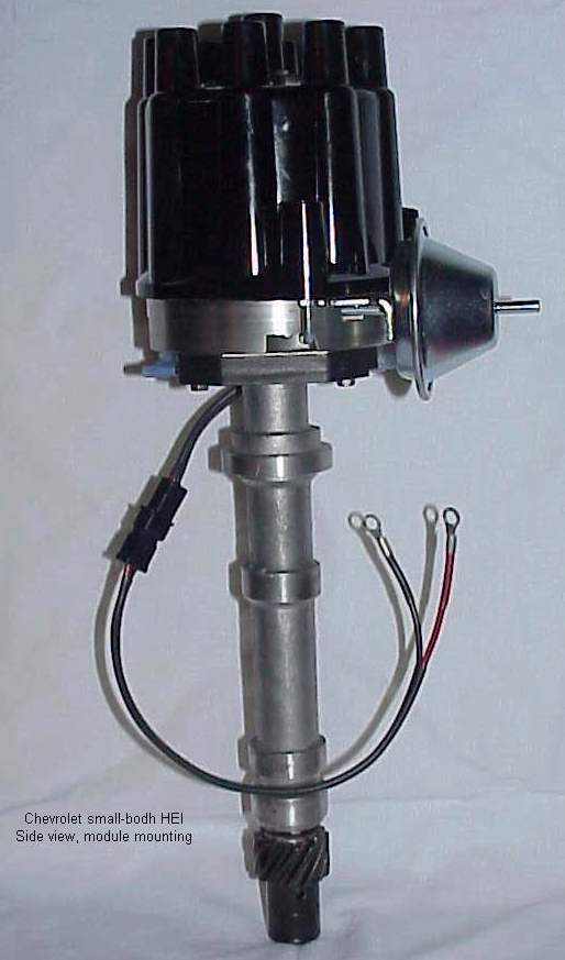

Have any of you tried the Pertonix Ignitor ì2î ignition system with there Flame Thrower
Coil and there 7mm stock appearing Flame Thrower plug wires, on your cars????.
The Ignitor 2 is supposed to adjust dwell above 3 grand and really work well. So they say at there shop, I am wanting to upgrade the ign system but look close to stock, any feedback would be appreciated, I have all the trick Mallory stuff new in the box but just cant bring myself to install it in the car, just donít look right.
Thnx Bud.
Attachments - The Supercar Registry 38790-HEI3.jpg 38789-HEI2.jpg 38788-HEI1.jpg
