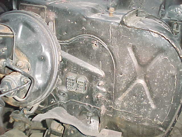

Friend just showed up in my office with a picture of a '70 427 Nova SS. Has emblems and decals from Berger. Documentation shows it was sold out of Berger. Was this an SS 350 with a later change or is it possble it left Berger with a 427? 81k miles. Jim

the block to that car is a 454 with winters intake late october build date and muncie trans. thi car was not on ebay last week all the signs point that this car could be a real transplant by berger. bbgg in yellow on fire wall

it was a 350 ss car radio clock delete 4 spd berger decal on fan shroun trunk deck and inside trunk to my knowlidge the car could very well be real large fuel line and prportioning valve under seat

Did Nova's receive proportioning valves on the frames?

My '69 Yenko did not have one, nor a friends '69 L-78.

That's what I was thinking, neither of my Nova's had one, and both are/were original when I bought them. I think BKH told me this past weekend that the Novas never got them?

My early-70 has a distribution block on the sub frame. Partway through the production year, GM made a change and consoliated them up under the master cyclinder.
