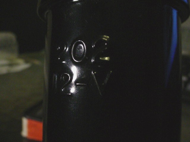

Dont know about 202 BR coils but I have a 202 12-V that was just opened.
...................... John Brown This isn't rocket surgery..... |
Vintage Delco

You're right & I'm definitely not an expert. There's probably no such animal as a 202 BR. Your coil would look great on my engine.... ![]() On ebay the other evening a Corvette resto company had New GM (Delco) 202 coils for $69.99 BUY it now. In the pic it looks identical to yours....maybe the way to go. ![]() I tried to look it up to add a link but now I can't find it, typical... I'm looking forward to hearing from other guys. Thanks, Rob
