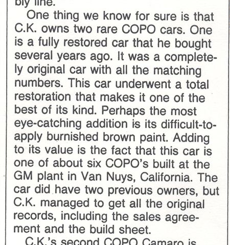

This may be a stupid question, but were any 69 COPO Camaros built at the California plant?

At least this one. Now owned by a member of this board I believe.

Steve, this is from another article where the car is featured. Bow-tie baron, Chevrolet High Performance July 1988. It doesn´t say where they got that "about six COPO`s built" from. They also state that the car came off the assembly line without a heater. I have heard again and again that in 69 all cars built in the U.S had to have a heater.
Charley, haven´t you seen the buildsheet from this car ? Is it true or false ?
