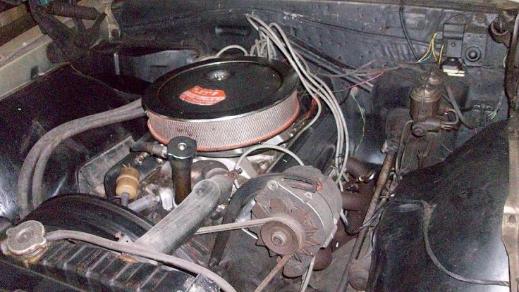

how about some engine picts?
Old 08-06-2009, 05:28 AM
L34Pace L34Pace is offline
Join Date: Aug 2004
Location: Seymour, IN.
Posts: 96
Default Re: 1967 Malibu L79
The carb and exhaust manifolds were changed out but I got the original carb loose. The motor has never been torn down and alt, starter, dist, all match up. I even think the upper radiator hose is original?

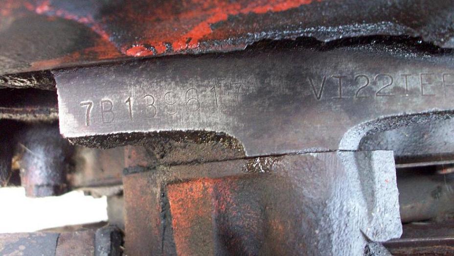

I think I'm satisfied with this engine pad stamp but not an expert on these.....good?

EP is an L79 code.
is the intake aluminum?

Yes, it's aluminum but the 67 used it with a Holley and the 68 was cast iron with quadrajet from what I've learned.

1967 took a 490 aluminum intake, not a cast iron unit. That carb does not look correct. What is the number on it?
