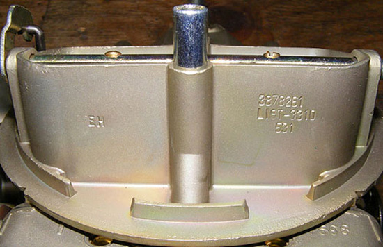

Here it is after restoration.

thanks, very odd dave m sold that car red car w/ black top with the wrong carb. but b body it is for my carb.

the carb pictured in the ebay ad is dated second week of May and it appears that the car was built in April so that is not the original carb for that car

well if someone is smart and wants to market a correct carb for a z16, that ebay car went for 183k and One would think that chap that bought the car would swap in a correct carb. Nice catch on the wrong date code, wow.

I have a 3310 off a '65 Z-16. Took it off myself. Has a May, 65 date? EH stamped on the left side of the air horn. Has the GM part # stamped on the right side but I forget what it is.
I also have another that is a service replacement. Same EH stamp and same GM part number but a different date and larger fuel inlets.

This one appeared on ebay a day or two ago.
http://cgi.ebay.com/ebaymotors/ws/eBayIS...RK%3AMEWAX%3AIT
This is just to add to the discussion. I have no idea or opinions if it is real or not. It does have the right bowls, dated 541 with the EH on the opposite side from the 3310 stamping on the air horn.
I have one of these also with the EH on the left side and date on the right. Dated 551. Ours does have the correct air horn and base plate.
