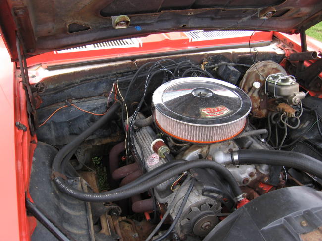

Here's how my (mostly) original paint red '67 Z-28 looked on the top of the firewall. This car was built 05A at the LOS plant.
-Jon
