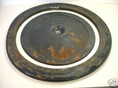

  #19
Old 03-03-2010, 05:46 PM
John Brown's Avatar
Location: South Bend, Indiana
Posts: 2,820
Thanks: 455
Default Re: air cleaner for a 1969 L72 427
Here is a picture of an original Camaro flange and lid. Notice no flat cut off side, it is mostly round or oval shaped.
This style flange is now available as a reproduction.
John Brown
