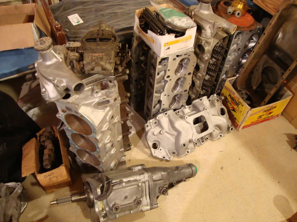

I've got this ZL-1 project waiting to be put together. One day i'll find the right car for it. Don't mind the 842's... they aren't for the ZL1.
