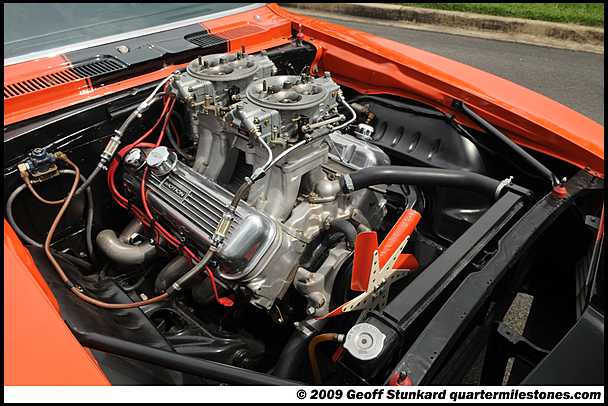

Ok, I like the 'Bread Box' look - but have heard about the washing down of the cylinder walls. I don't want to deal with that as it would certainly take all the fun out of this whole endeavor!
What are your thoughts on this one?
Offy Turbo Thrust
Marlin
67 RS Camaro-327/250hp, 2speed Glide, &amp; 3.08 Open (Danny's Ride)

Your engine looks great.
Does anyone know the time frame on the two pictured?
Don't worry about Stunkards picture of the Camaro. He won't mind.
It's not the critic that counts, not the man who points out how the strong man stumbled or whether the doer of deeds could have done them better...

<div class="ubbcode-block"><div class="ubbcode-header">Originally Posted By: Chandler</div><div class="ubbcode-body">Your engine looks great.
</div></div>
1974 ish...
