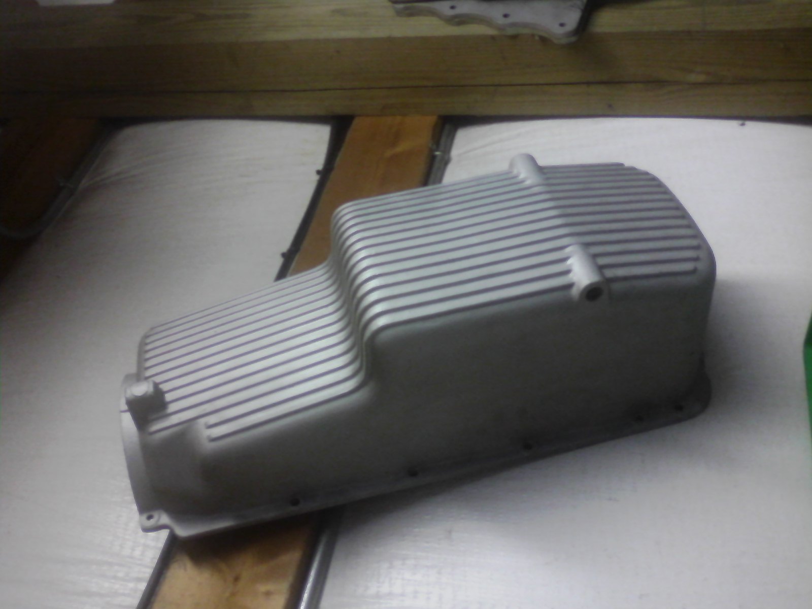

Default Re: 427 bbc finned oil pan
Finned marine pan.

<div class="ubbcode-block"><div class="ubbcode-header">Originally Posted By: Hemicolt</div><div class="ubbcode-body">Finned marine pan. </div></div>
I have had one of those hanging on the wall for years and always wondered what it was for...thanks for the info...
No problem. I picked that one up a few years ago to install on the big block that will go into my Model A project.
If anyone plans on using one of these, p.n. 47552 fits the two piece seal and 47552A is the later, one piece seal.
