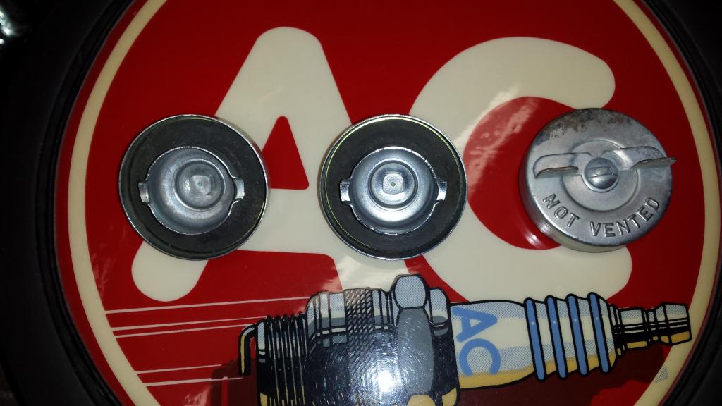

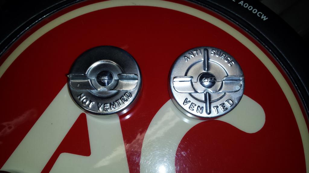

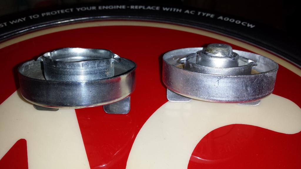

Hi Kurt,
Here's a few pics of the 1376973 part # cap that I believe is correct for 69 Chevelle. I have a few variations regarding the clocking of the lever handle that maybe somebody more versed in 69's can explain but it's definitely a deeper shoulder on the retaining tabs than the vented versions have which should explain why you can't get the vented cap to seal on a 69 tank.

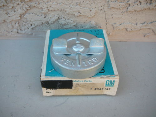

Great shots Chris. I also am 100% sure the non vented cap in your picture is correct for the 69 Chevelle car. Easy cap to find in NOS condition, look for Stant G32, Mopar used these too.
I also understand the wagons and Elky's use a vented cap, what I do not know for sure is weather it had the &quot;Anti Surge feature&quot; like the one in your picture, and the cap Kurt bought. I suspect it may have been this cap in the photo below. &quot;Vented with no anti surge popet&quot; most likley not needed because of the location of the fillere neck on these vehicals
[img]https://www.yenko.net/ubbthreads/pics...here_no_anti_s[/img]
On a side note on the Round no ears anti surge cap Stant G46a, these were used starting around 1962 through at least 1970 across the GM line. Does any one know when the cap with the 2 ears started showing up ?
Chris, I have had several caps with the handle assembled either way, most likley just the way they stacked the parts during assembly ? The tabs still end up on the centerline.

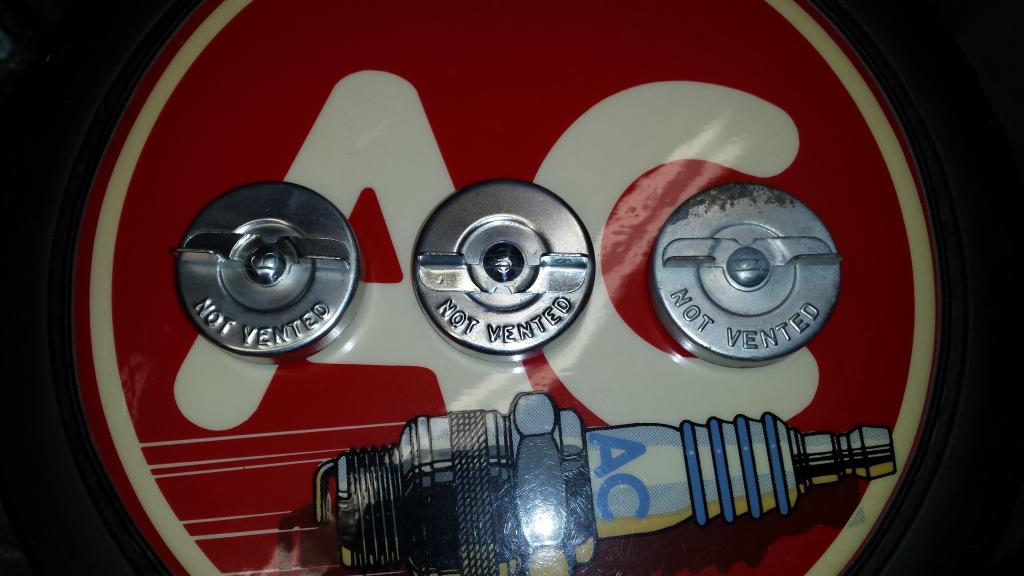

Here are a couple of pictures of Jerry Frailey's original gas cap off his '69 Chevelle.
It appears the tabs are installed two different ways.....they're not typical.
