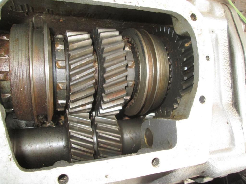

For those who don't know what these look like, here are the internals of a Liberty M-22 Muncie:

Jason,
Is this an actual Liberty's Complete internals of the gear set, Cluster, sliders and input or a Modified adapted trans done by Liberty's ?
I can see some but not a lot.....its tough seeing the inside of the sliders.
I see its an M22 platform, do you know the gear ratio ?
BTW, thanks for digging this out &amp; sharing. I'm sure the info and pixs won't go unappreciated or unnoticed.
Tom

I believe this is real Liberty modified stuff. I don't know much about it except I wish they left the original M22 that it was alone. This is original 2.20 stuff that was built long ago. Look at the time spend on welding each wide syncro tooth for a hardened and tapered surface.

The gear set pictured is Doug Nash stuff, the Pro-rings are part of the original gear blank, Liberty welded their Pro-rings into place...
I have a bunch of this stuff, I'll try to take some pictures of both... Crash
