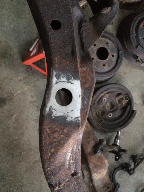

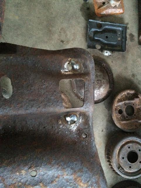

This was some progress today, as I have gone from no way to weld at home to stove pulled away from the wall, power cord out the front door to the garage MIG welder making nice bacon frying sounds:-)
The body mounts are welded up and the shock holes, need to dress them up and photo shoot later or tommorrow:-)
Ryan

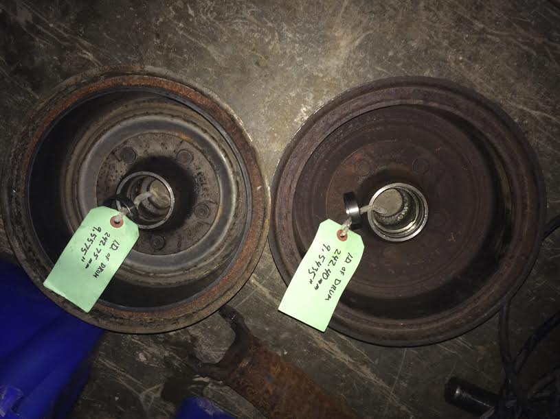

Still have to touch up the two mount repairs today with a wheel, and carve the shock holes back to original.

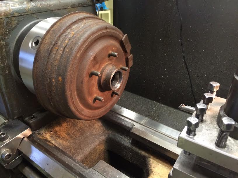

Got my front brake drums back from machining:-) Someone banged up the fronts of both of them:-(
Now I have to find out what the drum size is supposed to be.... PIM? One is 9.540&quot;, and one is 9.550&quot;

I discard drums is 9.590....do your drums have a &quot;safe to&quot; stamp on them?
If someone &quot;banged up&quot; your drums....it's not the place to do repeat business with [img]<<GRAEMLIN_URL>>/thumbsdown.gif[/img]

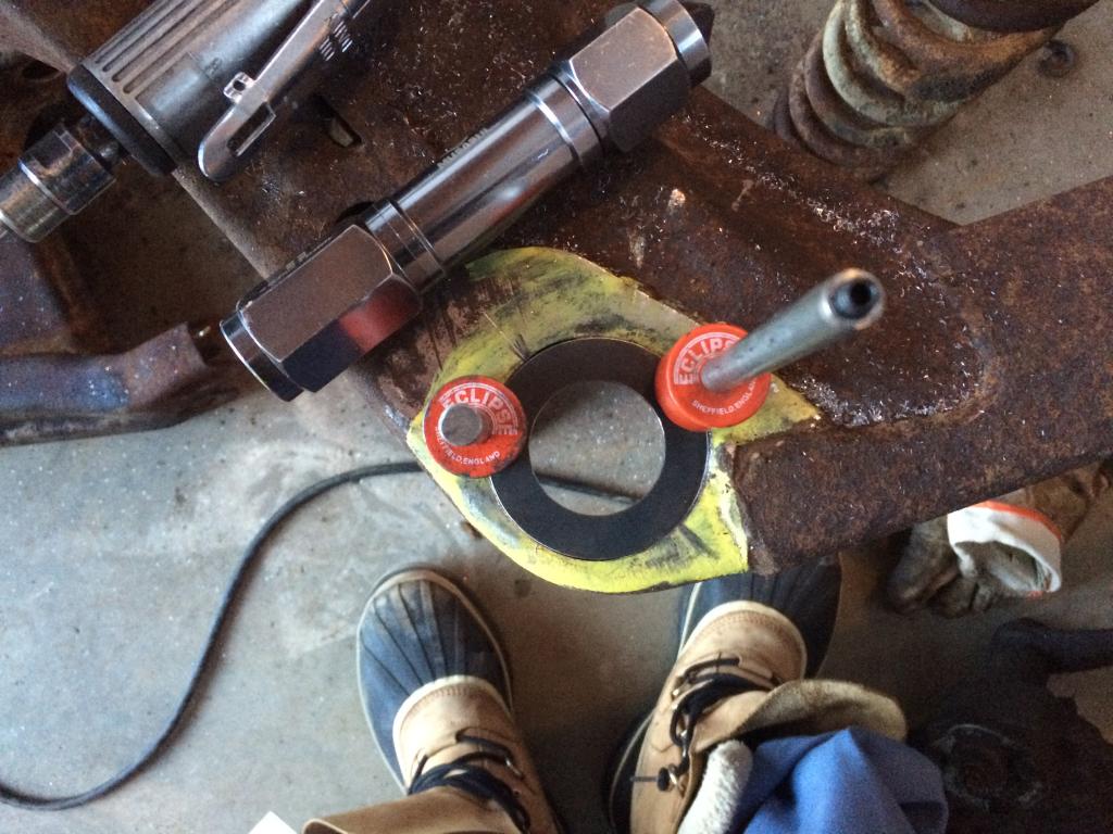

[quote=Ryan1969Chevelle]
Ryan
Just curious, what is the yellow goop [img]<<GRAEMLIN_URL>>/dunno.gif[/img]
Mike

I used an ink pen and shaded the whole area, then clamped on the repair ring, then scribed in the yellow ink, then used a die grinder to open up to the scribe line.
The yellow is probably similar to what line workers paint daub a torqued fastener for example.
