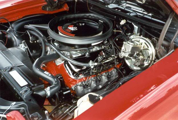

Who makes the best "rattle can" Chevy orange out there for the 1969 year? Best color and coverage?
