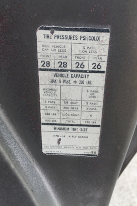

<div class="ubbcode-block"><div class="ubbcode-header">Originally Posted By: A12pilot</div><div class="ubbcode-body">
A little bit of a myth on that one.
</div></div>

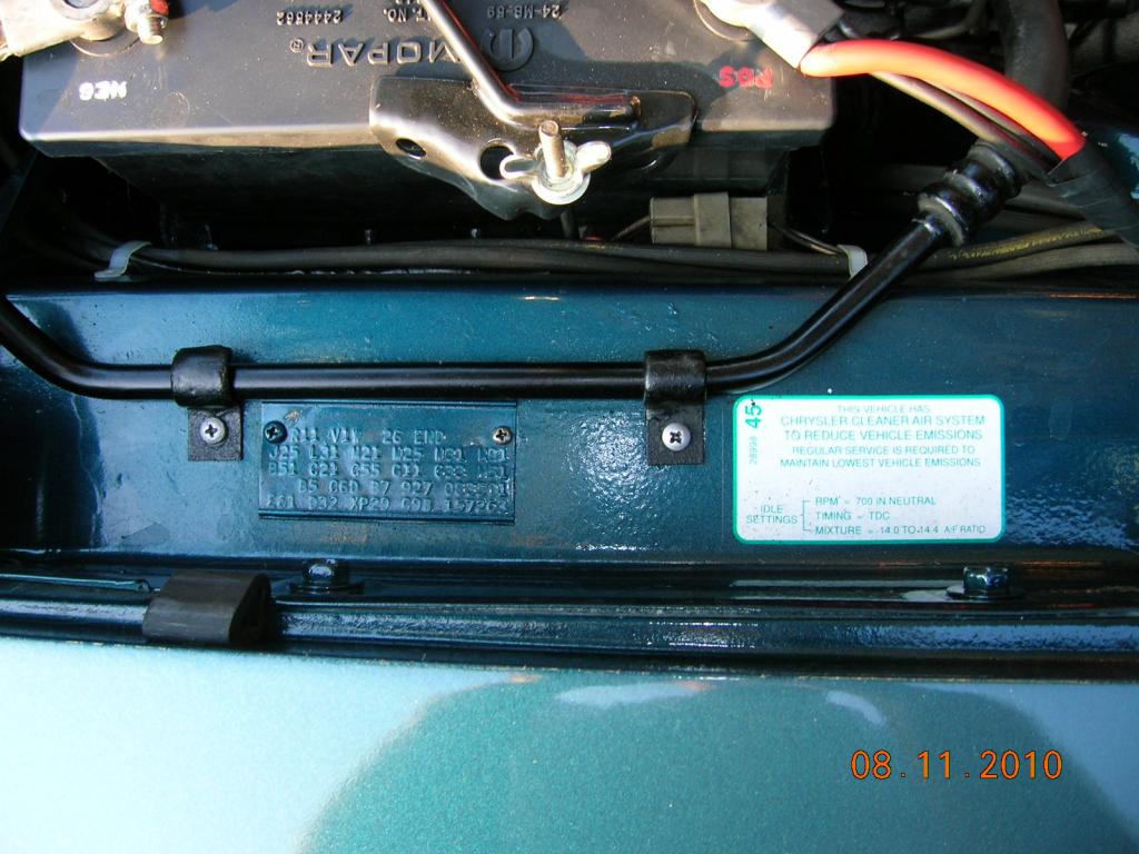

No, no myth at all:
I felt the context of the conversation made it clear I was talking about the Charger R/T. :twocents:
  #24
Old 02-22-2017, 12:42 AM
A12pilot's Avatar
A12pilot A12pilot is offline
Join Date: Nov 2014
Location: DFW
Posts: 2,793
Thanked 5,285 Times in 1,227 Posts
Default Re: 1969 Charger RT Resto
No, you didn't make it clear with the statement &quot; no AC with 4 speeds&quot;. At least that's not how interpreted it. See, my brain can't process implied thoughts. I can't think that deep! [img]<<GRAEMLIN_URL>>/grin.gif[/img] Now, if you said &quot;no A/C with Charger R/Ts with 4 speeds&quot;. [img]<<GRAEMLIN_URL>>/grin.gif[/img] then my pea brain would have understood Big difference! My misunderstanding, sorry about that.
But that chart isn't correct you posted either. Plenty of 383-2bbl Chargers out there with AC. I owned one. Here's the tag.....
69...383-2bbl, G-Code. [img]<<GRAEMLIN_URL>>/grin.gif[/img]
Unless that means 383-2bbl 4 SPD cars, and in that case, I haven't come across any 383-2bbl 4spd cars, much less ones with A/C. [img]<<GRAEMLIN_URL>>/dunno.gif[/img] And I believe the reason for that, no 383-2bbl 4spd cars that is, is that the 2bbl exhaust manifolds do not clear the Z-Bar for the clutch linkage. I know this because I converted that car to a 4spd and had to add HP exhaust manifolds. That 2bbl log dumped right where the Z-Bar mounted.
Cheers [img]<<GRAEMLIN_URL>>/beers.gif[/img]

<div class="ubbcode-block"><div class="ubbcode-header">Originally Posted By: A12pilot</div><div class="ubbcode-body">My misunderstanding, sorry about that. </div></div>
Nah, it's all good.
Anyway, I believe the item I posted was a pre-production piece because, after 1968, Chrysler stopped offering a 4-speed behind the 383-2.

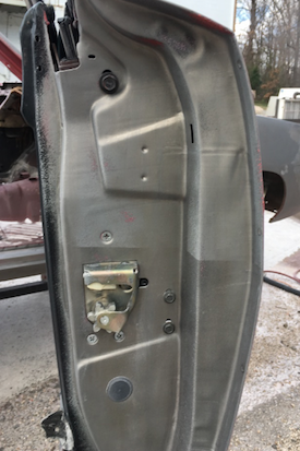

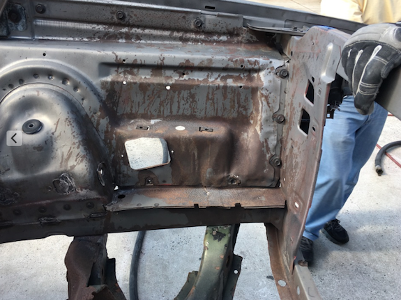

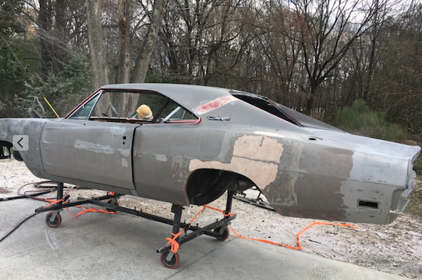

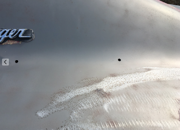

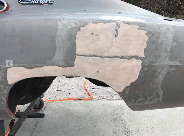

Old 02-26-2017, 04:53 PM
Join Date: Jul 2008
Location: NC
Posts: 1,320
Thanks: 51

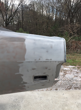

Here are some pics after the car was soda blasted. A few spot areas will be sand blasted but nothing major. The ole' girl was backed into or something similar based on the bondo on the left rear quarter. I knew it was there so no surprise there. Also knew of the front right fender above the bumper getting tapped. The only real surprise is that the front left fender had been replaced. Apparently back in the day best I can tell it is a Chrysler piece. Also there are a few pin holes in the corners of the lower valance, but thankfully nothing major. The trunk pan is questionable. Just the center section needs to be possibly replaced. I will let Ronnie the painter let me know his thoughts.
65 Corvette Coupe L78
69 L71 Roadster Survivor
69 Z/28 RS (Sold)
69 Dodge Charger R/T
70 W30 442 Auto Air Survivor
2016 Z06 Coupe M7
70 AAR Cuda (Sold)
69 L78 Chevelle (Sold)

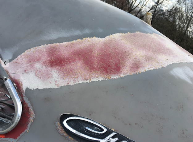

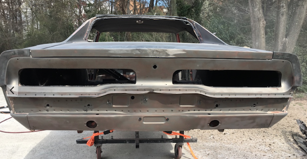

  #28
Old 02-26-2017, 05:00 PM
Join Date: Jul 2008
Location: NC
Posts: 1,320
Thanks: 51
I want to try and save the original headliner. Maybe a mistake?? That is the reason the Charger emblems are still on the sail panel. The painter was going to remove the bottom of the headliner and then remove the emblems. We will see, maybe just install a new headliner?

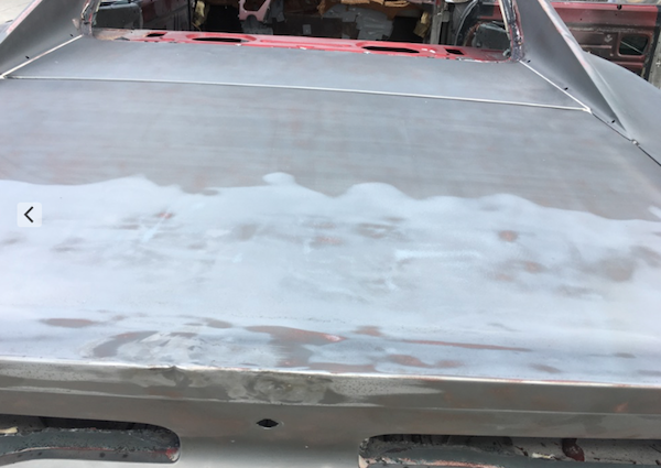

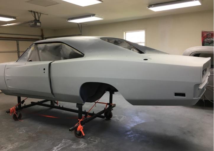

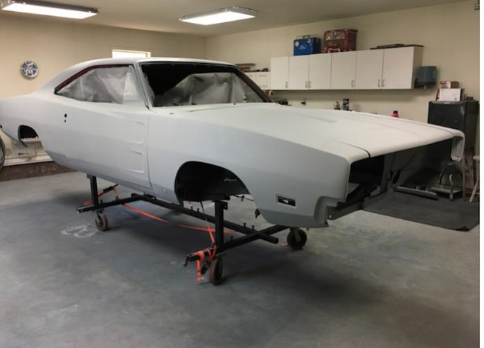

  #30
Old 03-13-2017, 01:13 AM
Join Date: Jul 2008
Location: NC
Posts: 1,320
Thanks: 51
Default More Pics

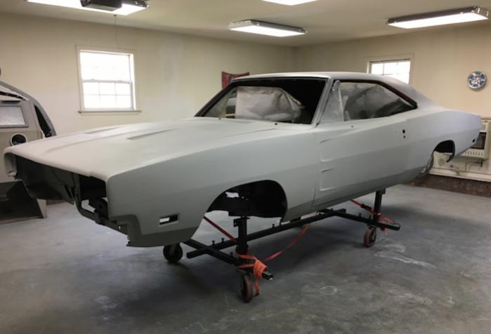

The body dings are fixed and the paint process begins.
